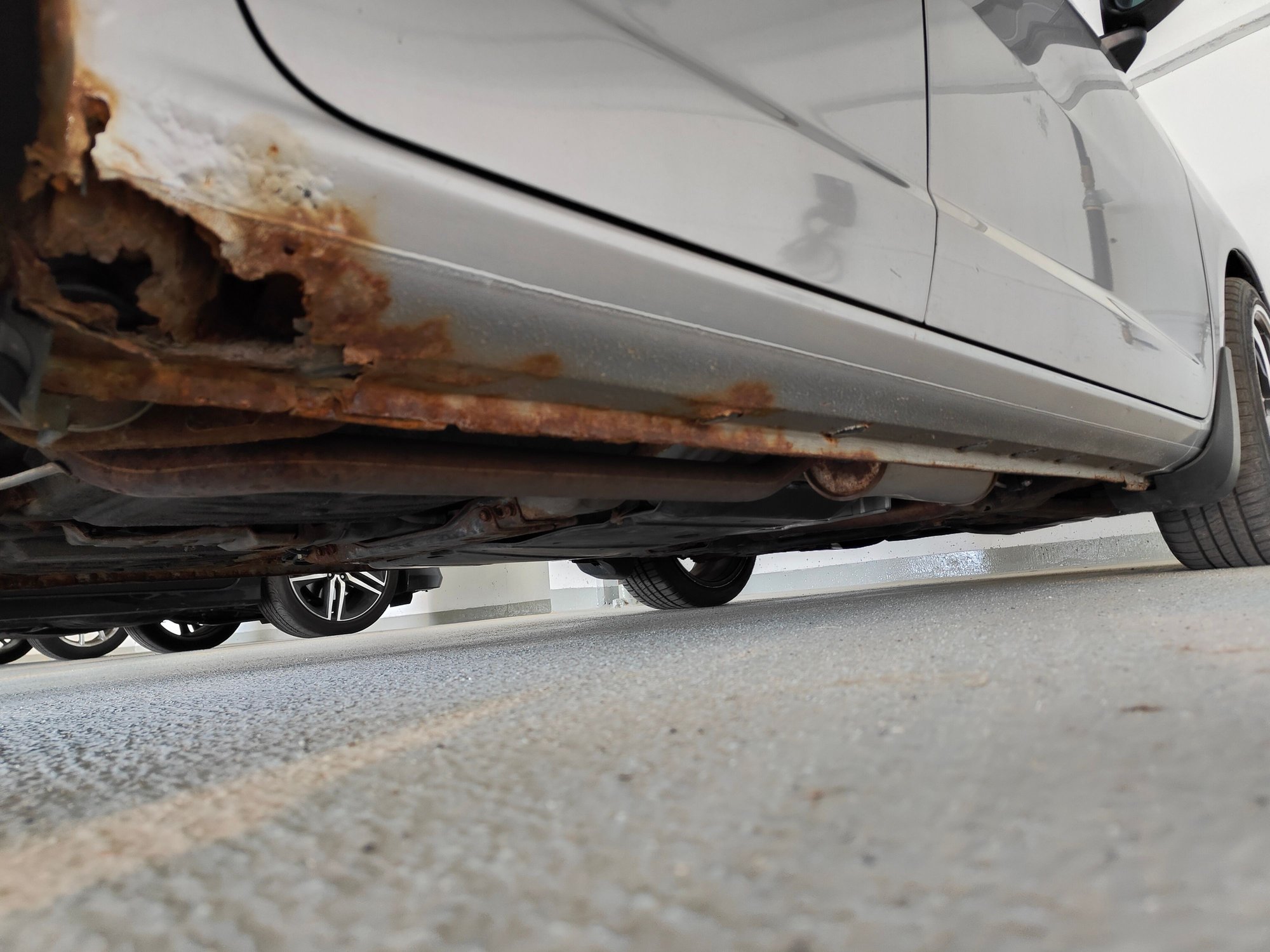

Originally Posted by Caconym
Ah, that looks familiar; my Chevy Cobalt looked like that from wheelwell to wheelwell, on both sides of the car. I finally had to retire the car for fears of losing the rear axle at the first inopportune bump!
The Fits do tend to rust quickly in those wheelwell arches. I hope to delay that on mine with frequent applications of Surface Shield. Hopefully it is warm and dry this weekend and I can power wash that area and let it dry, and then spray it with film. And yeah, it's got a peculiar smell.
