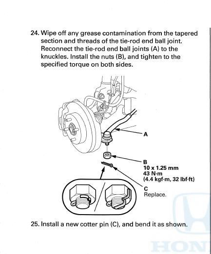

What is the torque spec on the nut that secures the outer tie rod end? I couldn't find it in the Service Manual.
Section 11, nut "B" in the attached image (right side of page).

Torque Specs are 32 lb-ft located on page 17-71

@mykizism Thanks, myk. I looked everywhere but there. I had a memory that we had discussed 32 ft-lb, so I went ahead and bought a torque wrench, but when I went back to check the torque value, I couldn't find it.

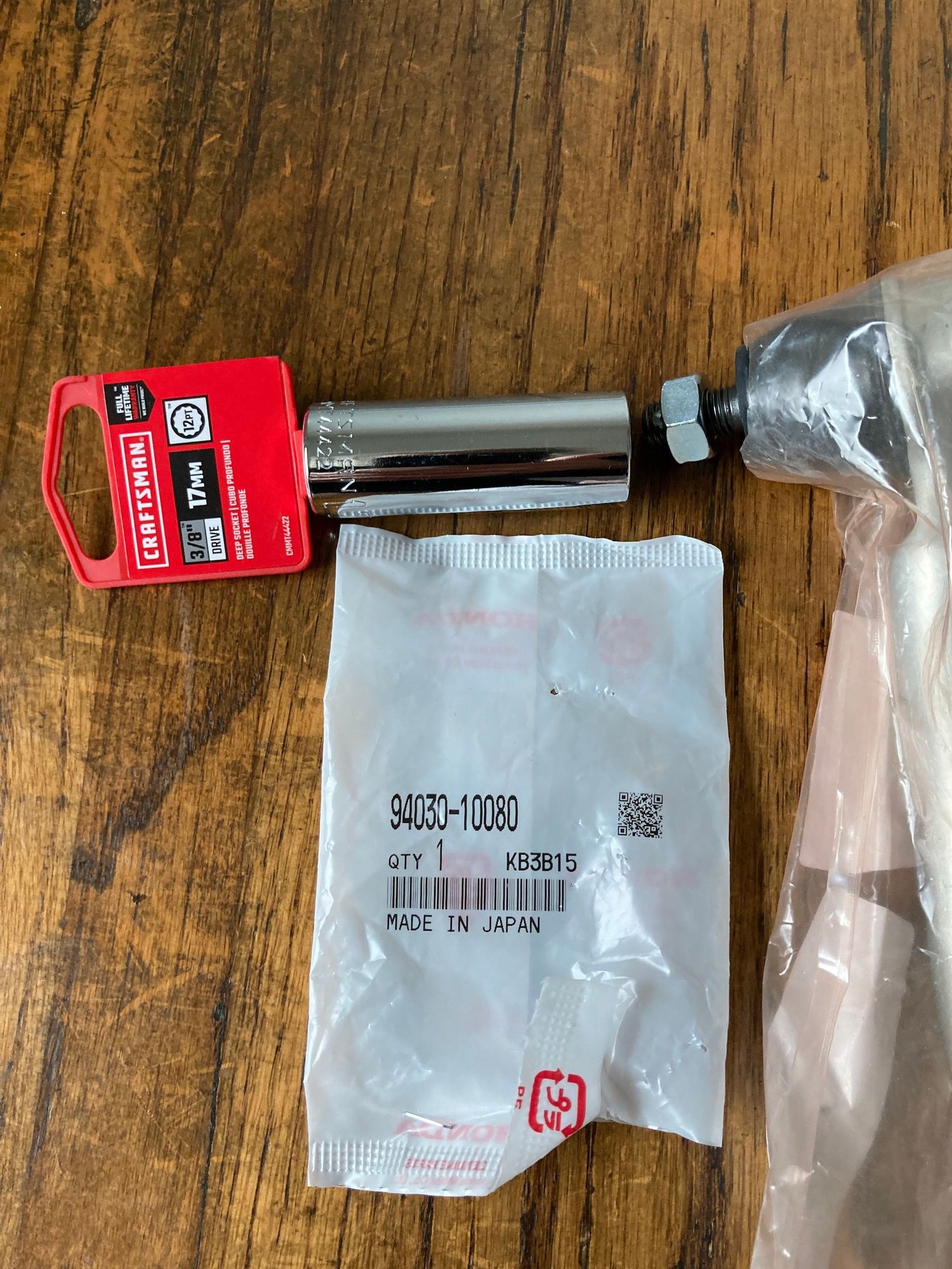

What is "10 x 1.25 mm"? I thought that nut was 17mm.

Oh, and the fastener dimensions you mentioned!! They have nothing to do with socket size! 1.25 is the thread pitch, and the other number (already forgot) is the diameter of the stud it's fitting onto/the hole in the nut.
When you go to buy hardware it's a real headache... You'll see bolts listed as (example): 8x60x1.25 That's an 8mm diameter, 60mm length of shaft excluding the head, and a 1.25 thread pitch (how far apart the threads are from each other). In construction one would be more accustomed to a pitch being labeled as "fine" or "coarse"
All that stuff is a headache, inclining me to purchase one of
these these
at some point when I'm flush with cash. A lot of times the hardware I pick up through Ace or elsewhere will wind up fitting in a different socket. Goodbye 12mm, hello 13. If your new fastener came from the dealer though, you should be good!

M10 is the size of the bolt (like the diameter of it) and 1.25 is the pitch of the tread (which is a metric sized pitch)
