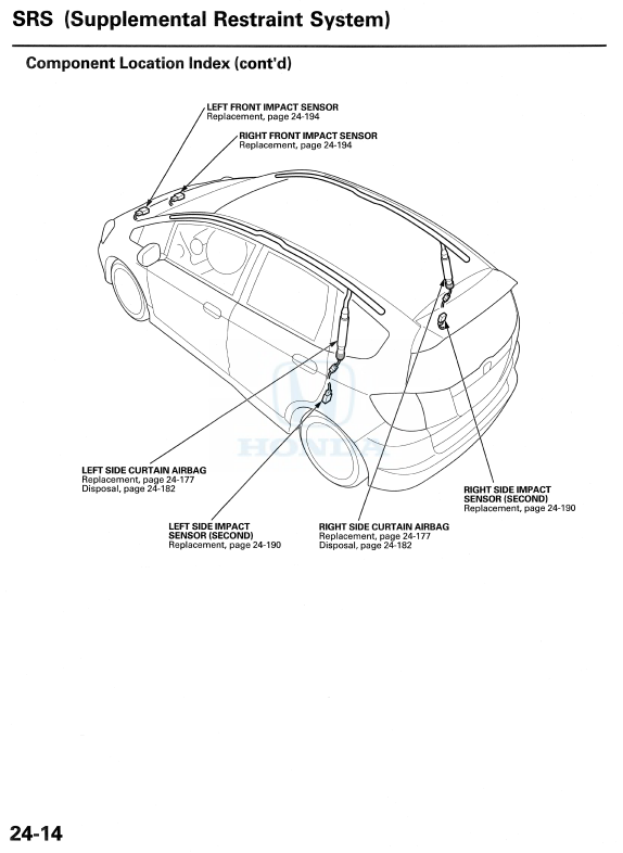

Now that you mention it. Is there by chance an impact sensor in the engine bay? Is there any documentation I could find listing the location of all the impact sensors? I specifically remember this issue cropping up after I did my valve lash adjustment. I sent it to see if everything was all good and that was the first time it had come on. I remember my buddy, who I bought the car off of, was surprised as well because him and I drove together and the airbag light never cropped up until then. And he would drive it pretty spiritedly too. I'll get it scanned at an autoparts store, my cheap blue-tooth scanner didn't work sadly. But please let me know if there's any documentation you can find about that. Everything I've found is for 1st gen fits, go figure. Anyways thanks for the help.

From the 2009-2012 service manual, which I downloaded for free. There are pages and pages about the SRS system, but here's the sensor location information.
I would also check the electrical connectors under the passenger seat. If the weight sensor connection is loose you might get odd signals sent to the SRS system, and I can imagine a loose connector being jiggled around during spirited driving. If you remove the four seat bolts you can tip the passenger seat forwards or backwards enough to check.

Alright, so after a few months of driving, it was indeed the front impact sensor. My friend managed to hook me up with a scan tool. I replaced it a bit ago and its been all cool so far. Thank you dhuang, Drew21, and Pyts for your help.
