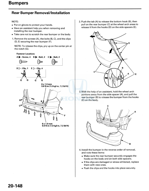

It looks like some of the bumper cover clips have popped loose. Did you bump something with that corner of the car?
You can just see one of the holes in your picture, which should fit to a matching "peg." With the proper manipulation of the bumper cover, you should be able to re-engage the clip, which will also fix the alignment issue along the rear fender.
The general movement you want to make when manipulating the corner of the bumper cover is down, in, and then up. Depending on how long it's been like this, there may be some "memory" in the plastic which might make the adjustment more difficult. I would wait until a sunny/warm day, as the warmer the plastic is the less likely it is to crack around the clip and the easier it will be to move.
If the alignment is off across a larger area of the bumper cover, it's not that difficult to remove, realign, and reattach. Again, much easier when the plastic is warm. I'm guessing there are Youtube videos showing how to do it, or you can check out the service manual. Here's the appropriate information from the US 2009-2012 service manual, which is probably similar but perhaps not an exact match to the procedure you would follow.

I highly suggest buying replacement clips. Things like that are almost impossible to get off without breaking clips and some are likely already broken.
