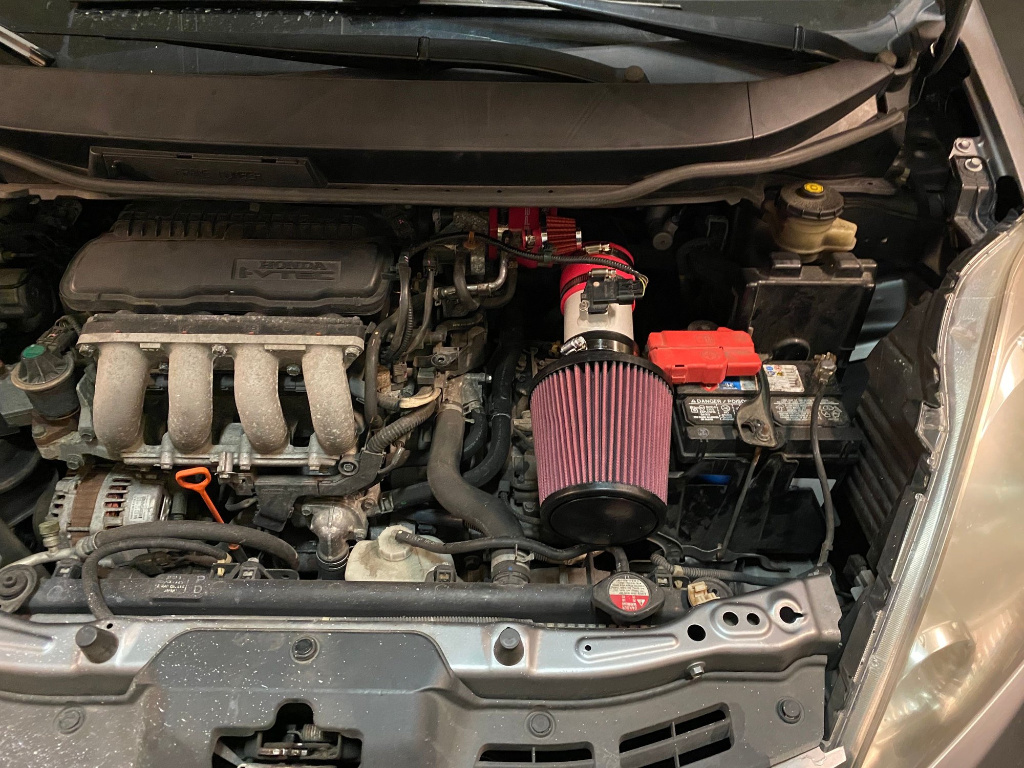

So I've trolled this forum for a couple years. Love the community. I recently installed a new intake on the old girl and.... it idles rough and quits
Idk what the issue is Below is the setup. Basically Specter parts and K&N filter.
And I know, I know, some of you will be banging your fists saying to stick with the stock setup, but I love induction noise and the look of the aftermarket stuff.
Please help this noob, you're my only hope.

Your stock air box will perform and look better with a performance drop in filter. Just swap it back.
Old Apr 23, 2024 | 09:48 AM
Red 05's Avatar
Posts: 1,122
From: Tuscaloosa
Your MAF is meant to work in a specific use case, so if air density flowing by the MAF changes greatly it can't compensate.
The solution: remove it all, return to stock or buy a different aftermarket hot air intake. K&N intakes have the same problem.

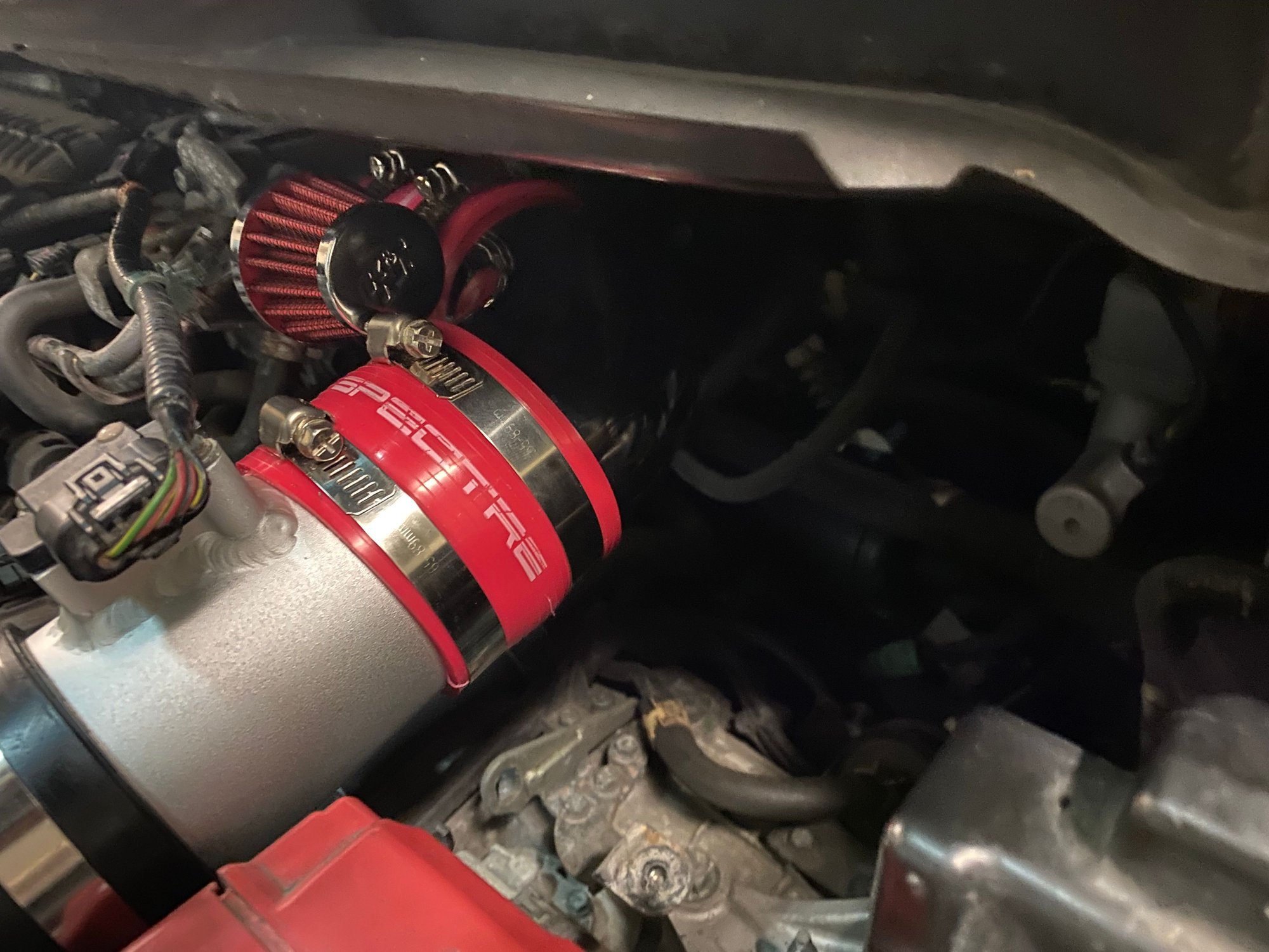

What is the little filter? Am I imagining things in thinking it is on a vacuum line.

little filter on the breather tube
https://www.fitfreak.net/forums/fit-...am-intake.html
more detailed pics of a similar setup

The problem seemed to be the diameter of the MAF tube. Needs to be same as OEM. Easy fix.
CEL is on but more than likely the ECU needs a tune since the intake and exhaust have been changed. According to MPG readout its running more efficiently, probably because its running a bit lean, but we'll see.

You got it figured! Ecm calculates air coming in and one of the non-variables is the diameter of the intake plumbing where the MAF sits -- that changes and its all boogered. Cant math!
As for the PCV breather, let me know how that works out. The way you've got it rigged, im pretty sure that lines supposed to run back into the intake, yeah? I'm all for adding a breather to pull outside air, but I feel like it should be a T fitting and still route to the intake. I guess with your K&N on there though, yer likely getting enough air to compensate.
Do you have a catch can mounted somewhere, or is that gonna get some blow-by goo?

Typically without some serious tuning/correction gear, the MAF needs physically about 1 foot before it of lean flow to work correctly, more is better.
Honda spends a ton of money on intake resonance engineering. Stock ECU's Seldom deal well as they could with air flow mods.

No catch can rn. I usually clean the MAF when I replaced to older filters anyway so I'll just keep doing that for the time being.
As for the breather, ive seen other DIY intakes here use the same solution I did. I'll link to it. Maybe lmk what you think. Open to improving the setup. Granted, their setup was on a gen 1.

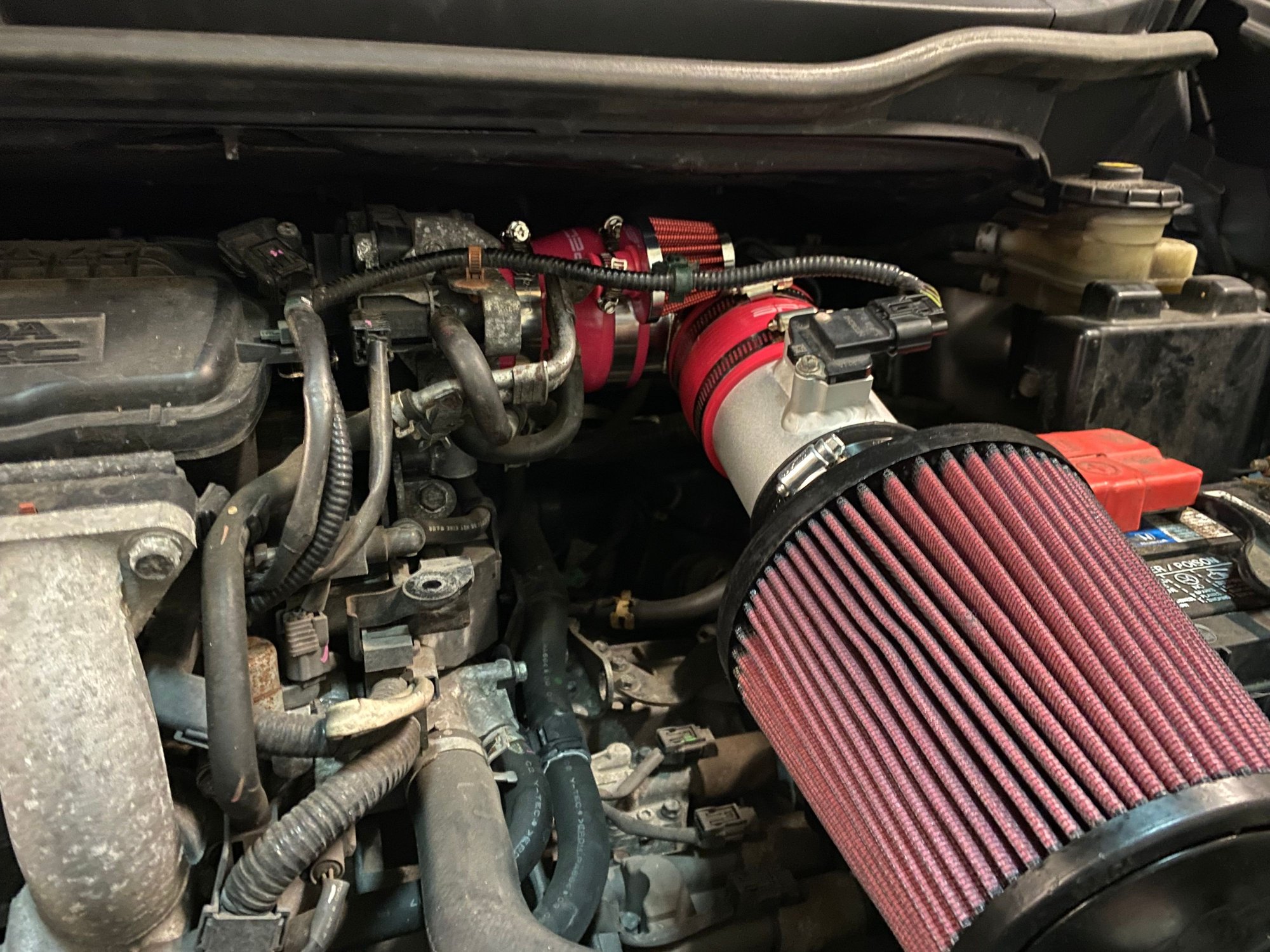

As far as distance from filter to MAF, there is more than what is shown in the pervious pictures. I added a 45 elbow and new filter sits somewhere right in front of the battery. I'll upload some pics if I get the chance.

Ah, I checked the thread and saw it better (or noticed). The line routed to the breather filter is coming from the valve cover, and not the pcv. I've got a modified PCV set-up myself, so I cant look at it for reference.
Keep an eye on it to make sure it doesn't get goopy, and don't overfill your oil 😋
