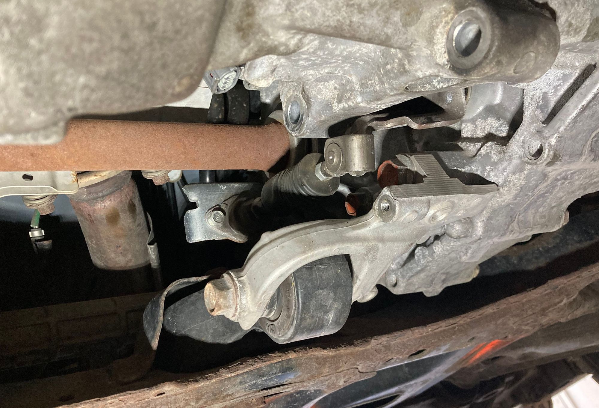

Finally got the pan separated from the block, but the pan won't drop. Looks like this shift lever linkage is getting in the way. The shop manual nor any youtube videos seem to mention this. Any workaround?
Am I supposed to remove the big main serpetine belt pulley as well?

The transmission shift linkage bracket needed to be removed to gain more clearance. Kind of important. Would have been nice if Honda included that in the shop manual.
