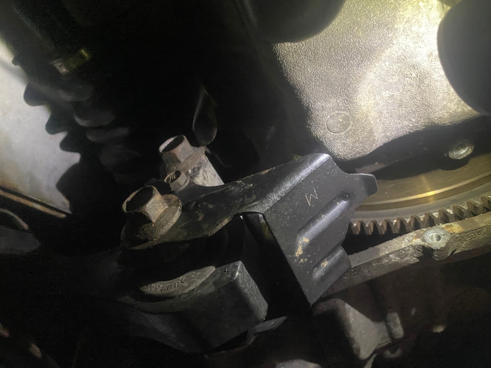

Oil old pan is off but….
I went through all the work to replace the oil pan on my 09 fit. As I finally broke the old one loose I realize there is a black metal bracket right in the way of the pan dropping. I’ll attach a picture this bracket is right by the rear of the17mm bolt that mounts to the torque converter. First does anyone know what this is? Secondly can I take it off without causing other issues?
Black metal bracket is right in the way
