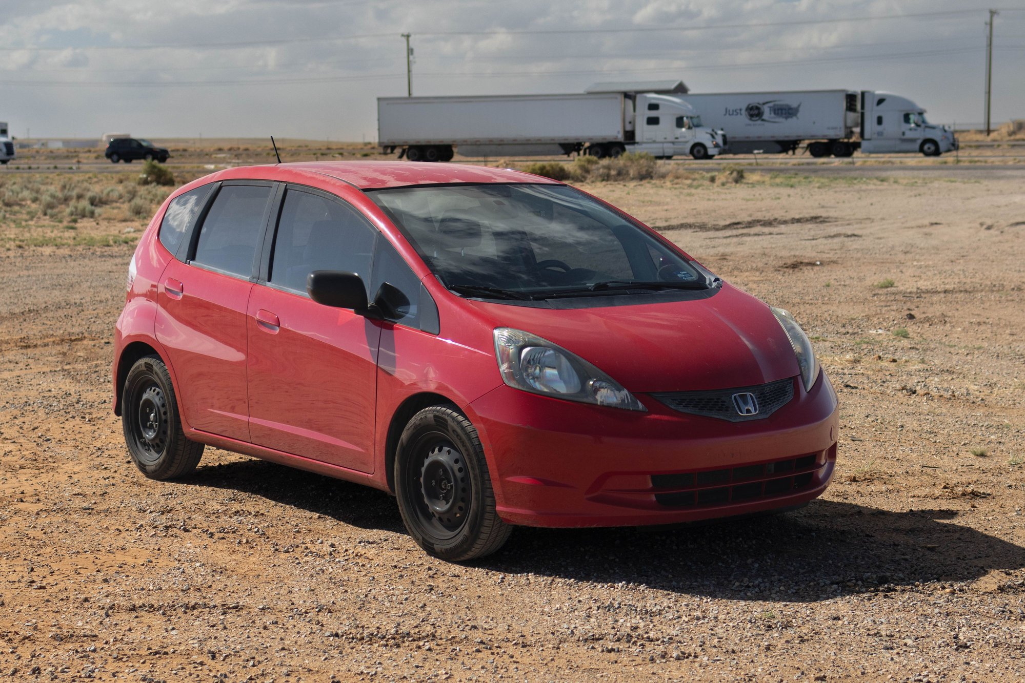

I own a 2012 MT base and regularly drive my local 15 mile downhill with it.
So far I have:
Replaced brake pads with semi metallics
Installed cam bolts
gotten an alignment with -0.5 degrees negative camber in the front
Installed CDV delete
Installed Progress rear sway bar
rear seat and belt delete
removed sound deadening
Spoon muffler (and baffle for highway drives)
The rear sway bar wholly transformed the way the fit handles and even improves the ride without the rear seats. I am able to enter corners much faster and more confidently now I'm not constantly wrestling against understeer. If you do not have one i cannot recommend it enough. just today I took a corner on an empty road at a speed that would have been slightly pushing it without the sway bar and it was so much more stable! it also feels less like the car is on ice skates when there is rain grooves on the highway.
Next mods:
GD coils
Konig Heliums
Acuity shifter cable bushings
Insight Control arms - looking at junkyard ones this sunday! (rebuilding them wont be a walk in the park i hear but im up for it)
rear wiper delete
How its sitting as of mid may 2025:
will attempt to keep this thread updated and add pics of installs and my fit at my local pass.
any advice on what to get or what i am doing wrong is greatly appreciated
Last edited by Nauwaysaint; May 22, 2025 at 06:35 PM. Reason: am updating this regularly
