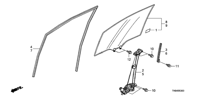

Door run?
Right: 72235-TF0-003
Left: 72275-TF0-003
Part 4/7 in image
Source: https://www.hondapartsnow.com/parts-...regulator.html

I'll bet you mean the one at the base of the window opening, though. I don't see a part number for those outside of the door assembly, which would be a little bit overkill
