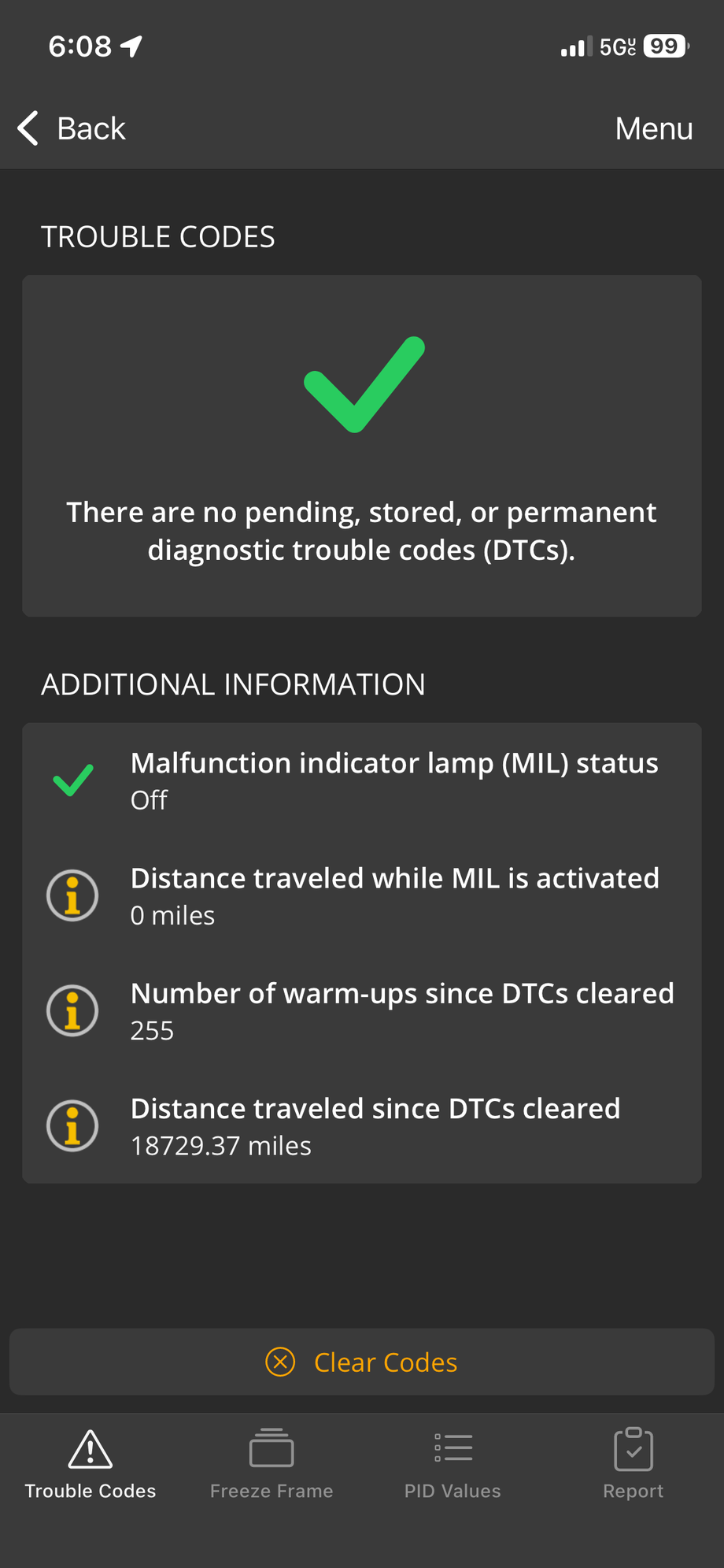

aaah thank you guys , no stored codes
loose spark plugs aye, snap that happened at 80k , I could smell fuel and ended up changing the plugs. I don’t smell fuel but probably should take a peek anyway….
yeah last thing I need is one to launch and rip threads off , that would really suck.
So , I’m going to clean my battery terminals and clean where the ground goes to the body (which I upgraded to zero gauge, and put new plug in again…
