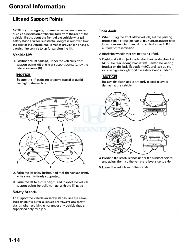

1) What's the best way to put the front end of the car on jack stands using the OEM jack points?
2) Please remind me where to place the floor jack if I had one that could reach under the front of the car to the center? There's a beam there, right? I'll try to see what the Service Manual says on this.

I will paste the official recommendations from the service manual below. On my Fit I regularly use the rear central lift point but my jack can't reach the front central point so I have never tried it.

@Drew21 Thanks, Drew. I don't think I want to risk damaging my side sills. Maybe I will buy a low-profile jack if I can find one that doesn't weight 100 lbs.
I wish I had a better idea of what the "front jacking bracket" looks like.

The front lift point is a hump in the center of the front subframe just behind the engine. There is no way to fit a jack under there without driving on ramps. The way I do it is to use a jack on one of the front side lift points to lift it just high enough to slide a second jack under the front lift point. Then jack it up, remove the first jack and put my jack stands under the side lift points.

I did what I had to do by using a jack to lift the right front jack point, then sliding another jack under the car and lifting from the center jack point. Then, I put jack stands at the front left and front right jack points. The only problem was that I was using pretty crappy jacks.
