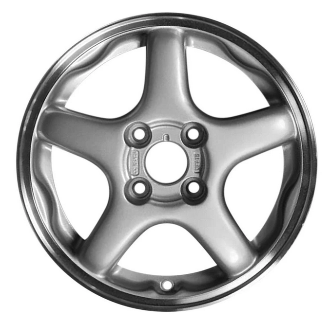

Frenzal's Avatar
Joined: Jun 2014
Posts: 894
These were the wheels I had. They cleared the caliper, but barely. Ran them for a few years without problem.
