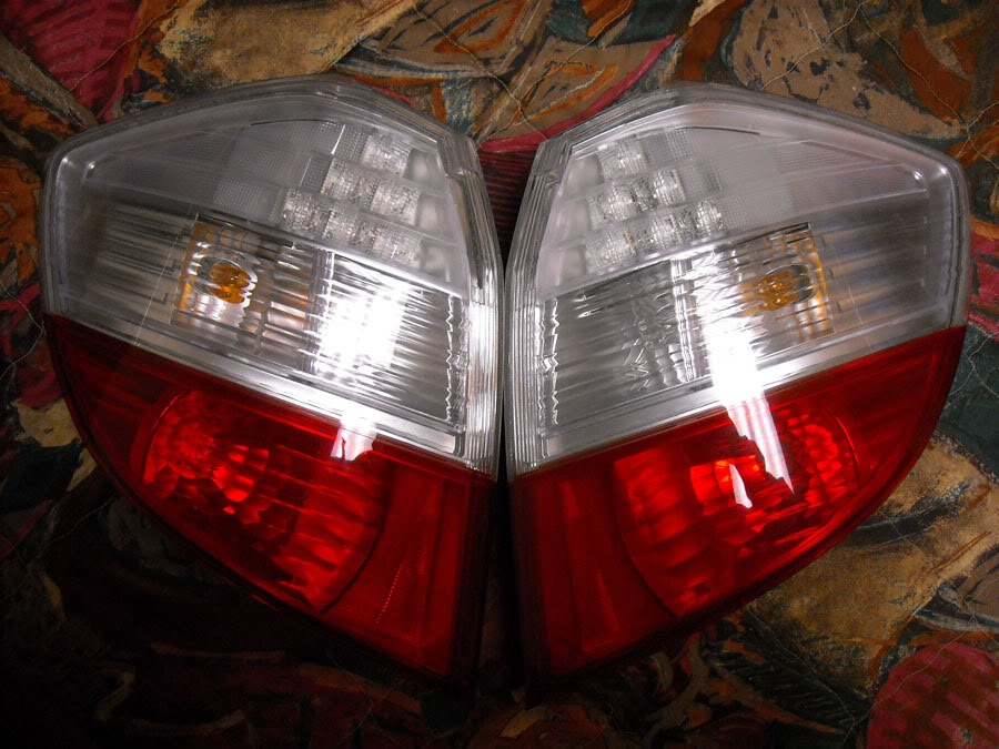

Which JDM GE8 LED tails do you have?
The ones JDM_DOHC had posted are the pre-MMC LED's.
something like this
You see the bottom section (it's not lighted, but there's a reflector in there....), so it's just a matter of drilling a hole for a socket.
Like this below:
Originally Posted by Jonny Black
a little of this
a little bit of that
and walla!!
from this CR-Z thread ---> little retro crx mod - Honda CRZ Forum: Honda CR-Z Hybrid Car Forums )
The modded pre-MMC's that were posted (by JDM_DOHC SiR) the bottom section light was only lit when the headlights/parking lights were turned on. They were not dual-voltage like regular brake lights. I believe the Noblesse GE8 modded ones were top/bottom lit.
I haven't seen the 2012+ JDM LED tails... post up a pic when you get them. I don't see why those can't be modded the same way as long as you have some space to drill a hole.
As for cracking them open and putting an LED board.... good luck, as you mentioned it's not like headlights. Did you check out Rich over at HID Illuzions (sp?), they do tail light mods.

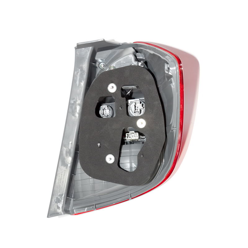

Thank You for your reply and lots of pictures.
I see how it was done now, so basically he just drill and carve the bayonet
mounting on the rear plastic,
but I think it is not that easy to be done on mine because my Tail Light
Had this grey looking thinner plastic... at least I think it is not that thick as
the black rear plastic cover on the picture you had above... (The CR-Z tail light on the picture above)
I also don't think mine had a reflector either, take a look at the lower version (from the back side picture), it is rectangular in shape,
while the JDM tail light that had room for foglight had round bowl like a backing of a reflector...
so if I put LED on it, it won't matter and the light will look good,
but if I drill and put a regular (NON LED) bulb in it, the lighting might look funny since no round bowl reflector there...
This is the JDM (Thai Version) Tail Light that I had (latest version):
This is the picture ALREADY mounted on my car
This is the Rear Picture that I download from the seller ebay page:

The backs of the lights I posted were CR-Z tails, (from the CR-Z forums) to basically show how the mod was done.
Mine (the pre-MMC JDM Honda LED tails), look pretty much the same as the ones you posted (with the light gray color on the back).
I was able to modify the bottoms just like in the CR-Z thread. I used a step drill till I got the right diameter hole, and then just notched out the tabs for the socket holder & a little dab of silicone for peace of mind.
I just mentioned the reflector as an FYI... but it looks like the new tails might have a reflector as well.
