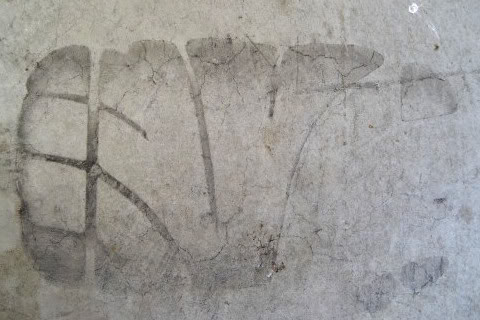

I don't know everything. There are some other sharp folks here! I guess I'm a little over-obsessed with tire pressures after running 295/30 R-compounds. There is not much rollover of the tread (nor sidewall) on those. Despite what Mr. Officer says, tire pressure is absolutely the name of the game--along with alignment (and suspension geometry). The exact tire pressures needed vary quite a lot from one tire's construction to another and for different things you might be trying to achieve/tradeoff. The lower the profile and the wider the tire, the more the contact patch changes from a long strip to a wide patch, and it becomes a huge challenge to keep that wide patch properly loaded and in contact with the road. Luckily, my Fit isn't as finicky.
This is a "foot print" of my 285/30. Interesting how you can see the shape, load distribution, camber, etc. Well, OK, at least interesting to me.
