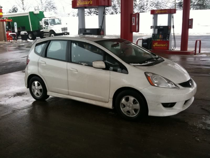

Went -2 on my Fit Sport - 14x5.5" ET45 Honda Del Sol OEM alloys with 185/70R14 Yokohama Ice Guard IG20's. The overall diameter is basically spot-on when compared to the factory 185/55R16, and the wheels (used on Craigslist - $100) and tires (new from Discount Tire - $182 shipped after $50 instant rebate and $40 mail-in rebate) set me back less than $315 mounted and balanced.
You know the OEM tires (I got stuck with the Bridgestone EL470's) suck horribly when you put on a -2 snow tire and realize how much more fun to drive the car is with them in ALL conditions.
14" wheels:
