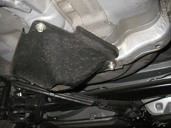

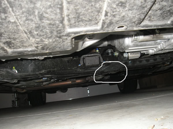

Old Oct 28, 2008 | 12:49 AM
TFB Designs's Avatar
Posts: 452
From: Morgan Hill, CA
Posts: 452
I'm glad I read this thread before ever jacking up the Fit. The diagram with the jacking points shown is for the Civic. On the Civic there isn't an apparent rear jacking point other than the tow hook. Someone please confirm that these are the correct jacking points for the GD3:
Front
Rear
I find it weird that this thing has a hole in the middle where the jack will go.
