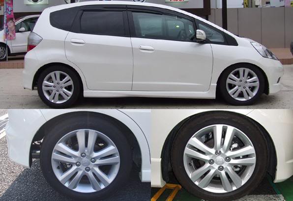

I hate to say this but there is alot of mis information...it was a risk, but Ive run springs on S4's that are A4 springs and stuff like that and have always been good...as long as it fits and the spring rates work with the car....so far so good.
Springs will work... but the shocks will not.... with those spring rates.... you are about x1.5 the normal spring rate in the front and about x3.5 in the rear..
But my hats of to you for willing to be a test mule..
the stock fit has the following spring rates( 09 GE )
1.8kgm F
1.6kgm R
Now those NF210`s for the ( GD 07~08 )
2.6kgm F
4.7kgm R
Here is a pic of the stock GD1 shocks and springs on a GEB chassis.. ( just look at the height of the rear and you`ll see )
thes would be great springs if you plan on drag racing your fit.... but I don`t think that your rear shocks will last to long with the springs that stiff...

Hmmmm I don't want to be the guy that spreads misinfo, so I will check the box again, but my drop is not that low, so far the ride is actually pretty nice, I will keep everyone posted if I have to pull my shocks then I will definately say so...its all part of the fun haha. Fear is the enemy of inovation!!!!!

OT: If i want to achieve this kind of drop in the front, i will have to install a GD1 shocks and NF210 combo on my GE8?

Yes I belive so..... the shock body is shorter up from so the car basically sits lower... with a ton of wheel travel....

Ichi, to be sure everyone knows as again misinfo is bad, I did not install shocks...
Old Nov 9, 2008 | 11:01 AM
Stormtrooper's Avatar
Posts: 424
From: Socal
Hey all after speaking with Mike my buddy and getting the Tanabe box, I had forgotten it at his shop...turns out I installed the GF-210...which as I had thought was the 20-30% increase in stiffness...where as the NF210 is the 5%, hence the difference in the drop between my actually car and Dave's posting. I DID NOT install shocks and stayed with the OE.
check out the front gap, as its not nearly as low...I would have fainted if it was that low hahaha, the gap is a sloid 2 finger, or about a 1.5 inch gap, the Fit still turns, and kinda looks sharp, IMHO...hope this helps anyone...I would suggest waiting a few weeks to see how the shocks handle the stiffer springs...Dont worry it wont be a long wait, I log about 120 miles a day.
