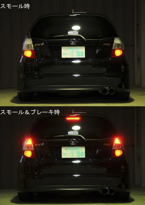

Get them up!! should look like this when your done right

Weird, the pic you showed above indicates they wired the LEDs to come on only during braking. I wired mine like the pics in the GUMP website, as both the LEDs and lamps I installed are running in tandem with the parking lights. I think I might change it to mimic the black fit above. Only need to snip one wire. Only the LED section "brightens up" during braking. The lower modified section is just a single filament 194 wedge bulb. I bought a set of sidemarker harnesses and bulb holders for an EP civic, cut off the plug ends and soldered the pigtail in parallel with the tail lamp marker circuit.

That exhaust looks amazing on that fit! Man I wish they would hurry up and start developing things a bit more quickly for our cars! I want this exhaust now!

I agree thats a nice looking exhaust. I want

Any info on this exhaust?
