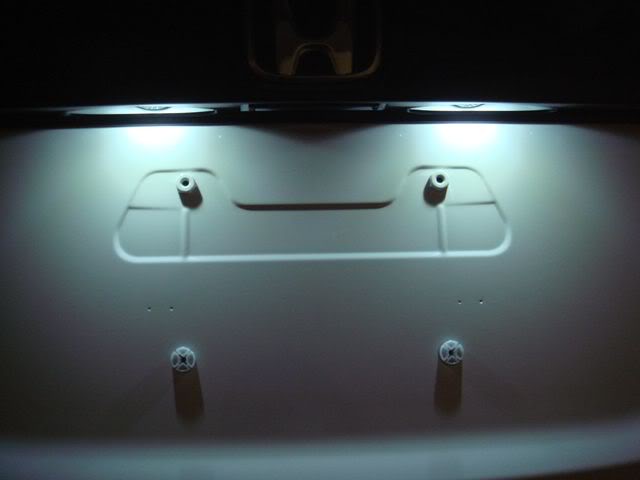

Is this what you guys are after? cost me no more than 10 bucks.
Yep! Looks great man, nice color temperature.
