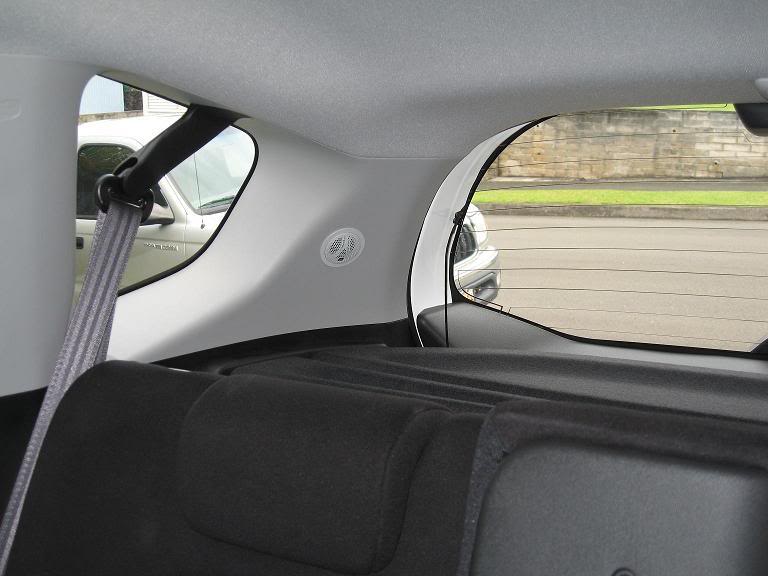

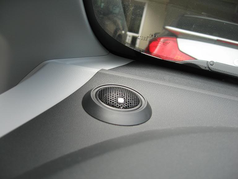

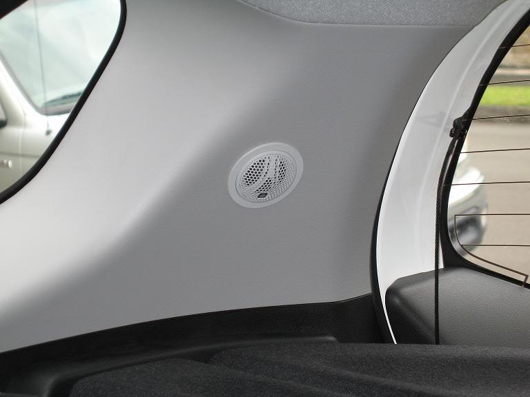

Here are some pics of my installation. My installer suggested that he install the tweeter for the rear speakers in the upper area behind the passenger window. He called it the sail panel. He experimented with different locations and said this gave the best sound. Different tweeters will sound different so it may not be the best location for other brands. He also painted them so they would blend into the sail panel.
The mids are in the stock location in the doors.
dash tweeter

Looks awesome man! Did you happen to notice exactly how the installer removed the stock front tweeters? Some members have inquired about this in the past. If it's easy enough I'll drop my A/D/S component tweeters in there until I get time replace the doors.
Old Mar 16, 2009 | 09:54 PM
aenokea's Avatar
Posts: 120
From: hawaii
Its actually very simple. If you look at the tweeter from outside the car, youll notice a very small opening where you can place a small flathead screwdriver and pry it off. Make sure you cover the scredriver with tape or something so you dont damage the dash or tweeter pod.
