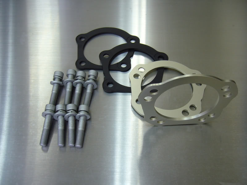

I think you need to do the same as the GD3 Fit. You need to either space out the rear knuckle (not sure it's the right name) by adding washers to the bottom or look for the expensive aftermarket replacement parts...I know Aeroover makes them-JDM
Found the link...looks like this:

The pic above of the shims is not the Aero Over camber kit for the GD. That looks like an xB kit. I have the kit from Aero Over and it is the entire spindle not shims
