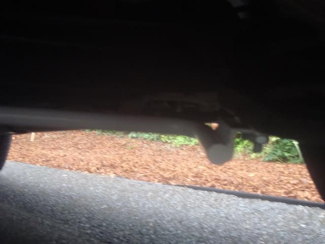

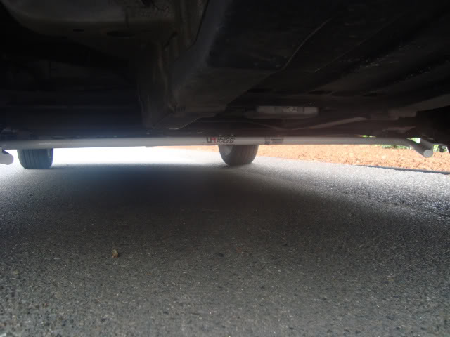

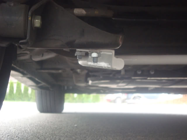

Just wanted to let everybody know that it fits fine. I'm about to go hurt the twisties in a bit with another Fit. I took some quick pics so the quality is not there, but at least it confirms that the bar fits.

Old Jun 20, 2009 | 09:22 PM
stevet47's Avatar
Posts: 307
From: Lebanon, PA
awesome, let us know what you think.

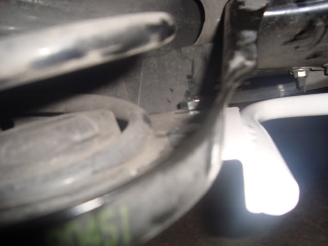

Do the bolt heads sit under the springs or does it clear?

I have a sport model Fit but my setup right now is UR c-pillar, UR rear strut bar, UR rear sway bar.
I will check on the bolt heads later when I have time and let you know but it doesn't seem like it would be a problem for those already lowered with springs.
The car handles so nicely with everything I have done to the rear of the car. It is really planted to the ground and stiff in the back.

Originally Posted by ekonetics
Looking at that picture and I'm wondering if it can be bolted the other way around (upside down) so that it would be tucked up away from road debris?

I don't think it can be tucked the other way since its angled to fit a certain way.
The install was easy took about 20 minutes with 4 bolts two on each side.
The bolts do not touch the spring it comes very close though. The heads are on top as well.
