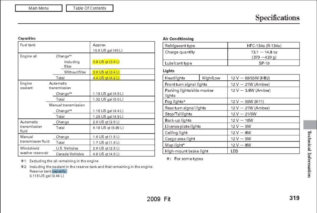

Oil capacity (base on Honda Owner's Manual)
3.6 L including filter
3.4 L without filter
4.4 L total

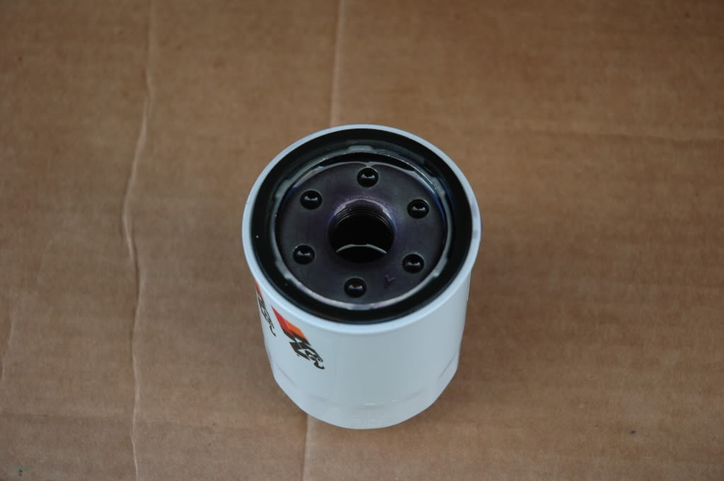

4. Oil filter location.

6. Remove filter
7. Put new oil filter. I ususally pour oil into the filter (around 1/2)

[quote=FITMugen;803767]Oil capacity (base on Honda Owner's Manual)
4.4 L total
Couldn't find that 4.4 liters in my manuals. And after rebuilds we only add 4 quarts (3.78 liters) and were pretty close to the full mark after idling for a while. Thats why my guess is a quarter of a quart. Don't know why it should be 0.8 liter, about a quart.
4.4 L total
Note to new oil changers: always make sure there's at least enough oil on the dipstick (near full) BEFORE you restart the engine and always fast idle for a few minutes before checking the oil level for running condition. Expect to find oil a little higher before starting the engine than after if for no other reason than the filter is filled. It will go down slightly as the engine distributes the oil.
This is where I got it from.

Full ramps are best, but a couple of 2x4's screwed together gives plenty of room. I know the manual says 4.4 qts, but I can just get slightly over 4 in mine after a full oil and filter change. The filter from below is a snap. Not like my older Hondas, between the block and firewall, hidden between hoses and wires. (Guaranteed to leak oil all over you!)
