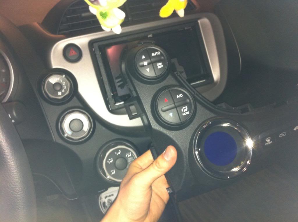

Big update guys.... It's here!!

dang that looks awesome cant wait till you get this done and a diy!
i always wanted one in the 4th gen prelude but i was definitely hesitant on taking apart the spaceship

Looks good connor55.... been following your progress for a little while now.
Can't wait for your complete detailed DIY.... I kinda want it just for that side mirror/rear defog logo... will go great with my heated mirrors when I install them.
Thats a single or dual zone climate control?
