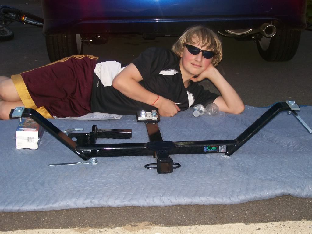

Here's the Curt hitch. It attaches to the frame rails left and right at the bumper junction, and at the pan in the center (drilling, I suspect).

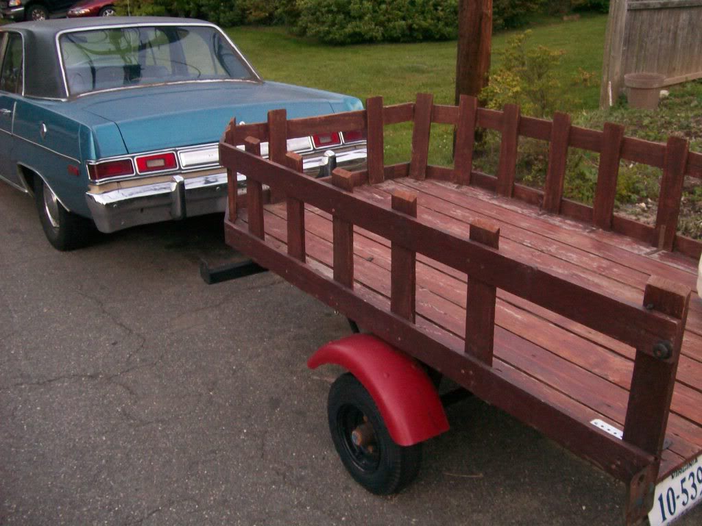

Here's my trusty 1977 Holsclaw dirt bike trailer, to which I added decking and sides about 12 years ago. That's a 1975 Dart in front of it, still going strong after 35 years, as I hope my Fit will.
How about that - a three point hitch for a FIT. Looks like it'll hang low. . . PIC when installed??
i can't touch it_ K_C_

I'll do a step by step installation this weekend. The hitch (#11064) claims 2,000 lbs. trailer weight and 200 lbs. tongue weight, but really, the load should be under half of that. My trailer has puny 8" rims, weighs 300 lbs, is meant for carrying bulky/messy loads rather than heavy ones. When loaded correctly, it has very little tongue weight. Great for carrying drywall/lumber/mulch etc. I once pulled a 650 lb motorcycle with it 300 miles at highway speeds, but that was with a tank of a Buick (1990 Park Avenue). I once towed a 1965 Plymouth Valiant home with a tow dolly attached to that car.
