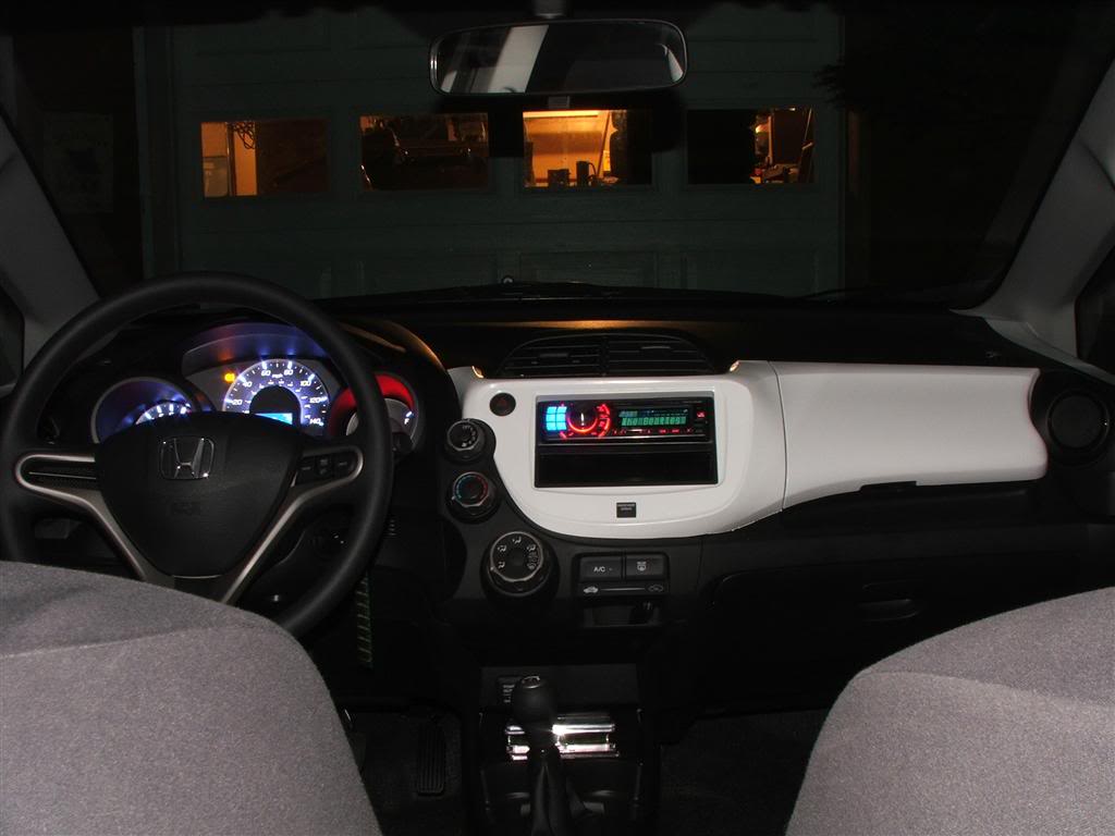

My solution was to install an Alpine CDA-150. $150 from Crutchfield and it comes with everything needed to install it. You have to relocate the passenger airbag light but that's easy.

Thanks for the info. I am looking at a receivers on Crutchfield and have decided that I want Bluetooth. I have a few more questions.
1. Was the install difficult? I cannot seem to find how to remove the radio,but am sure that Crutchfield will supply instructions.
2. When you say it was easy to relocate the passenger airbag light,did you have to do any modification to the dash kit?
3. Did you keep the factory speakers,or upgrade them? If so,what speakers did you get? Looking at speakers on Crutchfield,I'm thinking of possibly going with $50 a pair replacement speakers or leaving the stock ones,and a powered under the seat sub.
4.Did you need an antenna adaptor for the radio, and if so was there an additional charge for it?
5. How do you have your iPod connected? It looks like the cable comes out of the rear of the radio. Will it feed into the upper storage area?
I really appreciate any feedback.
My primary reason for wanting to change the radio is for better iPod control and display. I hate to spend the money and swore I wouldn't mess with the radio,but am finding the iPod integration poor after nearly 6 months with my Fit. I was looking at a double din unit, but the cost is much more for what I want.
The instillation wasn't difficult if you are reasonably handy with some tools. You have to take the upper glove box cover off (two screws) and then take out a bolt that is a PITA to reach but doable. then gently pry the bezzle off.
The instructions are included. If you pull the little plate the USB cable for the current iPod input is on you can (with a bit of cursing and reaching around all through the dash) get the old cable out, then snake the new one into the same spot. You will need to unclip the lower glovebox to do that. You squeeze the sides and it flips all the way down, there are just rubber stoppers to hold it up.
You will also have to have a wire stripper and either crimps or some soldering tools so you can make the head unit to Honda adapter. This is typical for any head unit install though, since they all use different plugs.
You have to cut some electrical tape that holds the wires for the airbag light to the wires for the hazards switch. Piece of cake.
I have left the factory speakers for now. The original head unit has a built in EQ that you cannot disable that gets rid of all the mids. The factory speakers are OK as they are. I will probably replace them in the future.
Crutchfield included everything I needed, including the antenna adapter and the wireing harness adapter.
It sure will. The alpine came with a 6.5' USB cable to extend the short one and an 8" ipod to usb cable as well.
The control for the iPod on the alpine is is much better. The display though is a bit of a setback. With the angle and height the head unit installs in the fit you are right at the angle the text display is hard to see. You have to sit up and forward to see it. Not a big deal for me since I don't like extra displays anyway, I find them distracting.

Are you sure it's not the CDA-105?

It sure is the CDA-105. That's what happens with dyslexia.
Should have checked the box, which happens to be sitting right in front of me, before I posted.
