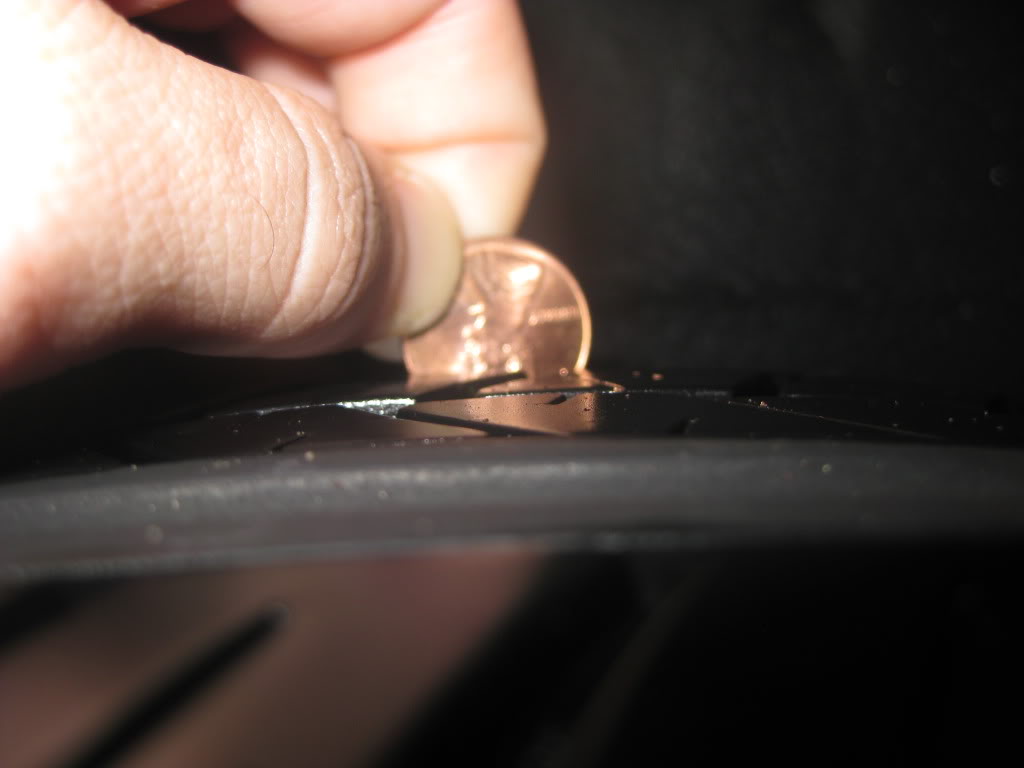

I don't have a tire gauge, but I do have a penny.
The thread seems to be at the eye level of President Lincoln. Does anyone know what that translates to?

Oh, here is a pic of the current thread around Lincolns eyes.

My guess... and it's only a guess, you have something like 7/32" of tread depth. Based on that guess, you're close to 1/3 into the tires' life.
