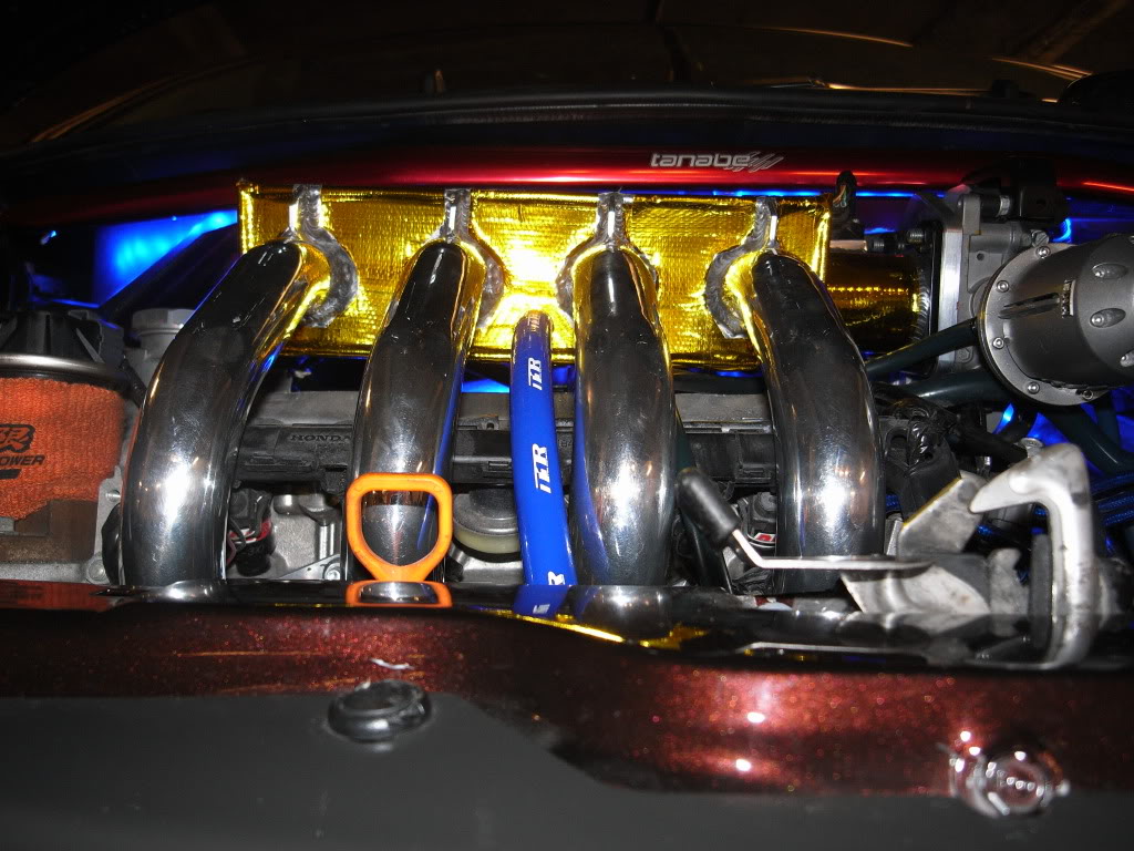

You are one of the few in the Fit community who would definitely benefit from a bigger TB and manifold.
But I have my concerns about the Weapon R Intake manifold, and it seems like other guys with big builds on here are having trouble. Specifically Felix. A few others have had major issues as well:
https://www.fitfreak.net/forums/fit-...-manifold.html
Originally Posted by FELIXY69
in the end...this is a POS from over seas
it will gain...but where? 9000rpm ?
my experiences are
it looks like shit, it's not even straight....weld sucks..and it broke after couple months.
Originally Posted by kylerwho
my manifold finally cracked. i was looking over the design and there is one flaw i found. they overlapped the aluminum plates to form a butt weld rather than a corner to corner fillet. i have had my welds crack before because of this problem.
Here is one that came crooked from the manufacturer:
But if you want something solid and serious I can get you in contact with some premier fabricators..
If the intake pipe is putting so much stress that it is tearing through the weld over time with vibration.. a few hump hose couplers would help alleviate the problem. However, I have only rarely seen damage like that on a N/A engine thats never had a nitrous backfire. Usually it was due to questionable manifold construction.
Also, a big square plenum, long runner manifold is the worst of both worlds.. Choke up top on the long runners, low velocity down low through the big plenum.
Ideally on a small displacement 4cyl that is looking to make better power overall, a tapered rounded plenum with intermediate length (5-9" depending on goals) stacks would be the way to go.
YouTube - dsm intake manifold simulation
Fluids don't like sharp corners.
YouTube - CFD simulation of vortex shedding
If you want a nice manifold for your Fit, call up ShearerFab, JMFab or DVDT. Respectively, Ron, Jim or Albert will get you something just as "blingy" that will actually benefit you in some tangible form. Just tell them what you plan to do with it.
Now if money was no option this is the route to go:
Or for the more serious track guys:
