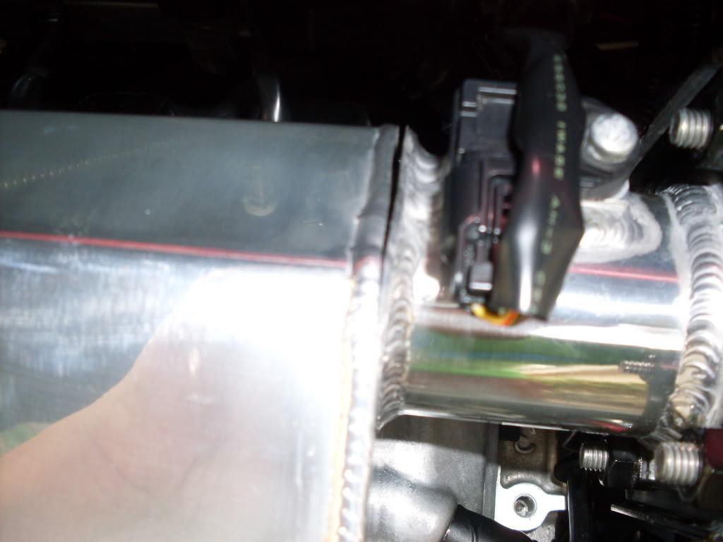

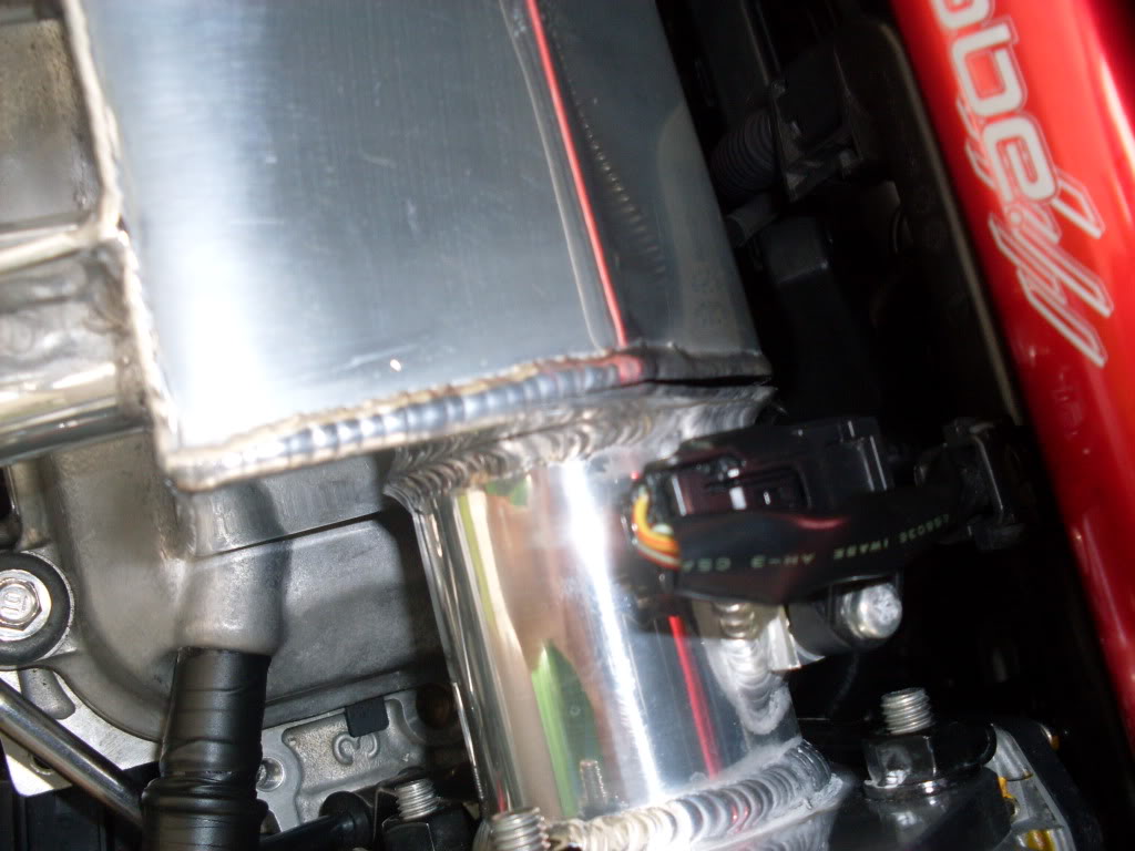

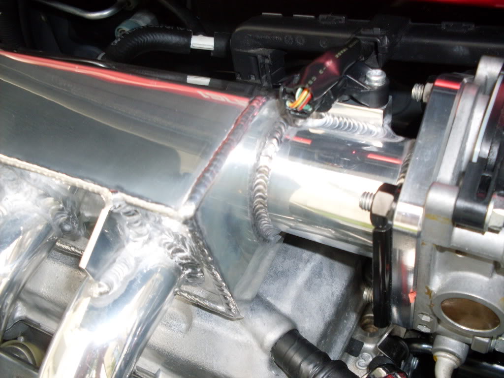

I called weapon-r and spoke to chris, I dont know who he think he is but he has very back customer service,I sent it back today but im still not sure what there going to about it they dont either.BTW stock manifold stays way cooler and it has more response and torque.Name:  SDC13908.jpg

one moreName:  SDC13910.jpg

Judging from the pictures, the weld broke due to the it not being centered at the point of were the two pieces meet. It seems as if the person welding that section started to drift up from the joint as they welded it from left to right with the intake opening towards them. Then afterward they started long arching, which reduces penetration, as well as continued drifting up. Regardless of that, the person welding this and/or Weapon R should have caught that flaw.

That Injen air intake comes in pretty tight through the stock air port doesn't it?
I wonder if it was putting stress on the manifold everytime the engine moved?

This isn't the first case where stress from the engine movement has damaged something,
I know a few other intakes have experence the same problem and broken as well. One that comes to mind
is the H-Fit intake.
If you intake has no where to move and you tighten it right down into that space, something has to give.
The constant forces from movement will eventually stress parts to the point of failure.
