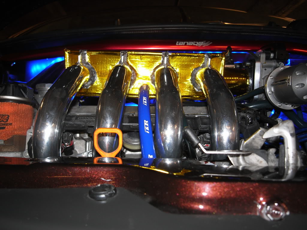

Originally Posted by FELIXY69
so a total of 2ppl have cracked the manifold
mine isn't crack YET...and i hope it doesnt
but the quality of the product is so shitty to be honest !
mine is not straight
Did you bolt it down in the rear behind the TB? Maybe it's just because mine is the prototype, but there's a place to bolt the IM to the engine right behind where the MAP sensor is. After a few months, I noticed mine was sagging like that too and realized that I hadn't bolted mine in there. I pulled it back into place, bolted it down and now it sits perfect. I think the reason mine sagged was because the weight of the intake slowly pulled down on it since there was nothing to support the weight of it on the upper part of the IM. Especially when the IM gets hotter, I would imagine that the metal would be more malleable

did you have mounts for the intake?
i can see where the rattling from that intake to the throttle body would just break the weld. must have not had a corner to corner weld and did a sealing job so the weld was really thin.
there is not alot of weight on that manifold so it should not sag that much. mine is crooked too but it doesnt bother me.

Having the Welds break is looking more common due to the fact that the Engine sways a lot. If you got motor mounts of a torque damper, the chances of the Manifold breaking will lessen by a lot. I've broken mine before and with strong material welds. Got motor mounts now and is now holding.
