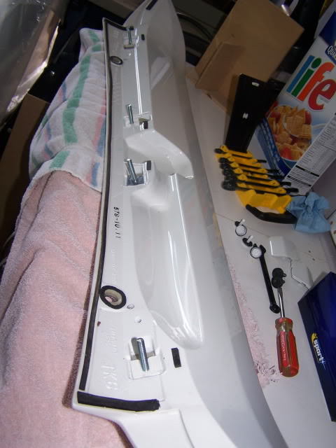

I would hate to drill two holes in my roof for the spoiler. Are you replacing one on a Sport ? THat has the holes for bolts? If so I woul drill the spoler for the bolts.
He is a pic of mine. The two black circles is where the bolts go. The 4 bolts you see are where the stock clips would go. I am using hte bolts to tilt the spoiler.

yeah 4 screws held by the bolt with a washer in between is typically how spoilers are mounted... as long as you have the washers, they shouldn't come lose.
