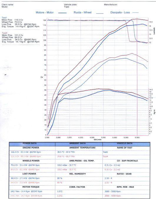

Here is the dyno from the Race Craft Academy reflash. RCA stressed that this is on a COMPLETELY stock Fit. Judge for yourself:

Lyon, this dyno graph should change your mind about wanting to extend the redline further....

Great find! I wonder why Henry @ RCA told us in the J2534 Flash thread they made peak power at 7800rpm?

No wonder I keep short shifting this car a bit, even when I'm driving hard through linked turns. Cause I'm liking that torque curve! Awesome find, thanks for posting it.

Wait guys, I need to clarify this is a stock Fit (blue curve) with a "REFLASHED" ECU (red curve).
Henry@RCA might have been referring to gains beyond 7,000 RPM with less restrictive exhaust and intake....??

^^ you are right on your last statement.
The graph also explains why well boosted Fits eat autox for breakfast

You're probably right about that, which goes to show how restrictive much of the stock setup is. The torque curve is nice and flat for both though!
I also noticed that the fuel scale that says Lambda, even though it is in Gas scale AFRs, shows that the reflash and the stock ECU run stoich all the way till past peak torque (VEmax) and then they start diving pig rich (for NA @ WOT).
Granted we are considered high compression, but at 12.0:1AFRs beyond ~6500, they are half a point richer than Max Rich Power. Do you think this could be for margin of safety? I wonder what peak timing is on both maps?
This was on a tank of 95RON if I remember from our conversation in the other thread. the spread up top is relatively wide though, which tells me a few bolt ons and one could really reap the benefits of a wider rev-range.
