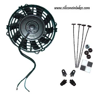

Noticed auto trans coolers were brought up... for track use or towing they are a great idea, and they are NOT expensive.
The "expensive" bit is finding adapter fittings, and even that is not bad, there are all sorts if you go through Jegs or Summit.
Once that is done, select a larger cooler, pick up some braided SS lines and -AN fittings. Install the new cooler, and mount a switchable fan to it.
Derale Series 7000 Tube-Fin Transmission Cooler Kit w/ Hose Barb Inlets - Class II - Standard Derale Transmission Coolers D13106
Slim Radiator Fan
http://www.frozenboost.com/product_i...e30ef971939739
