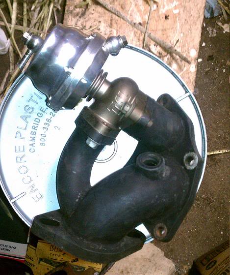

To take advantage of any turbo you are going to want to seperate the wastegate discharge from the turbine discharge and have them join together downstream if you intend to recirculate the wastegate. Like this:
