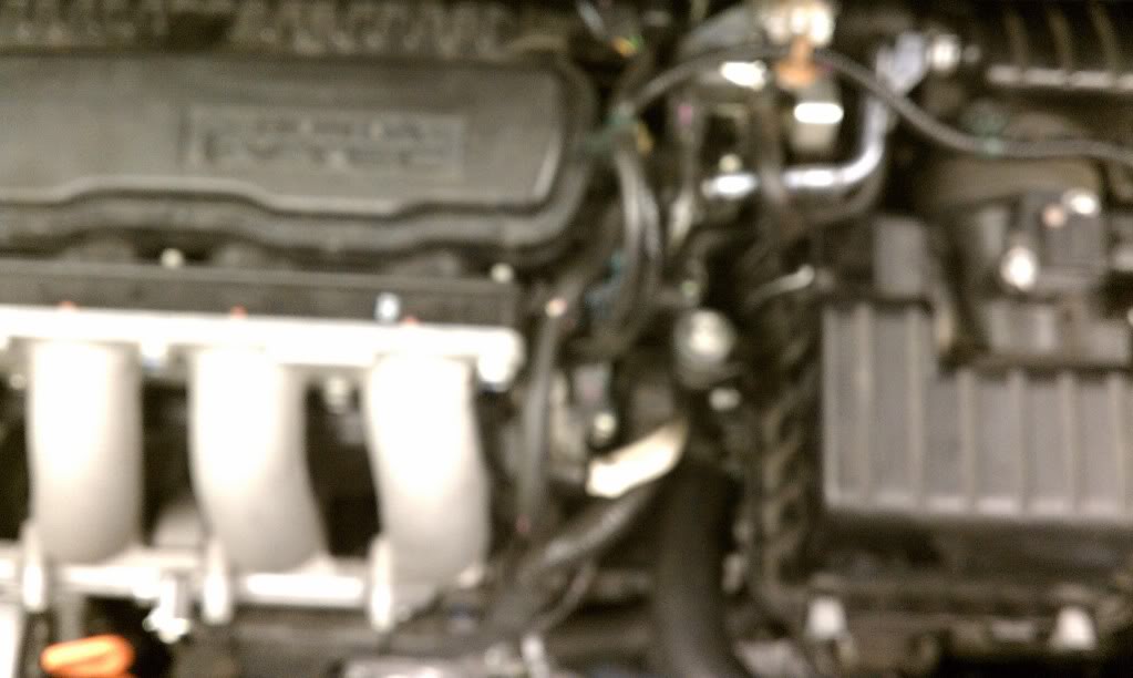

It looks like the technician did not seat/seal the intake cooling hoses correctly. Looks like there is some coolant residue on the intake. Anyone else experience this?
