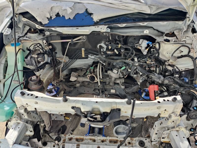

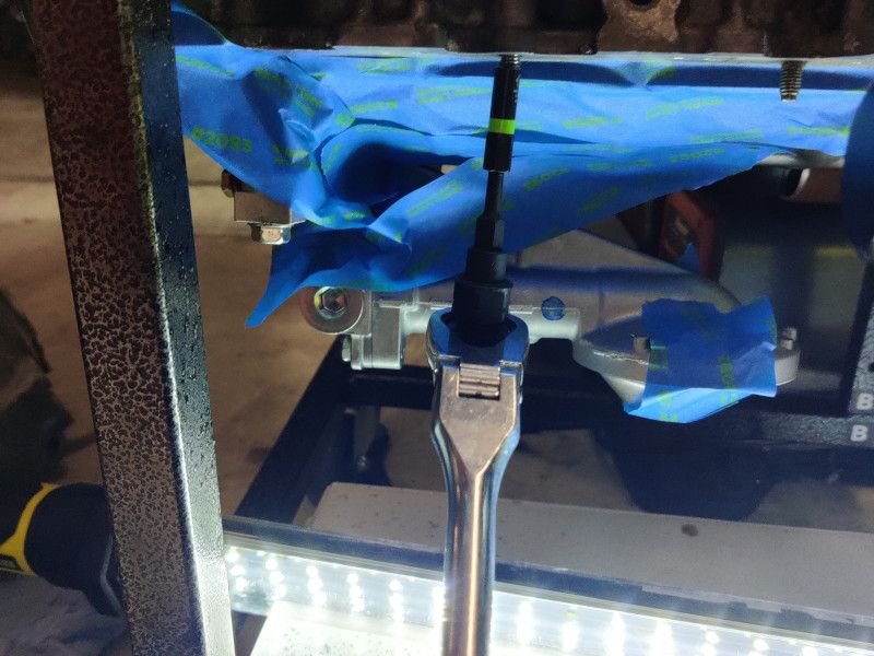

Thread update
All the prep work has been done and everything else needs to have the engine in the car.
Got to love when you go to put the oilpan on and realize the previous owner left you a broken bolt to extract.
L15 is out.
The bay has alot of surface rust and I cannot just move forward without taking care of the issue now. So that is next before I actually put the engine in.

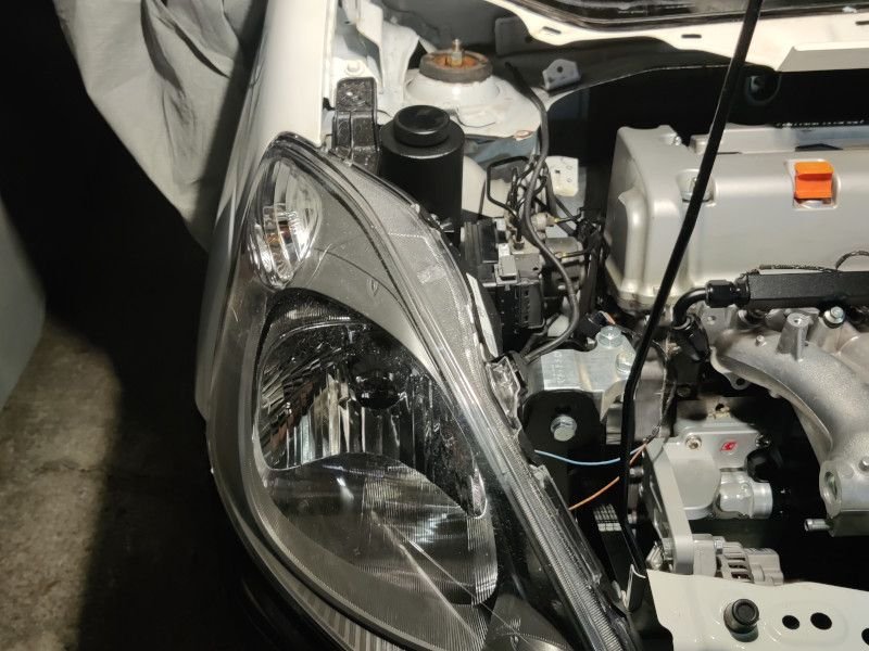

K24 Installed.
k24a2 swap
first issue I am running into is clearance between the electric water pump, alternator and the radiator/fans. This radiator is a s2000 rad with mishimoto fan/shroud combo. The setup hits both the water pump and alternator.

Originally Posted by OhItsRy
I would try using some slim fans. Those helped me with my kswap.
The fans I have are slim's. Mark from HSG who just k swapped his GE said he was not able to use a fan on the usdm pass side because it would hit the radiator/alternator also. It doesn't help I have the electric water pump setup also. It is also hitting. I think he was using oem fans though. I would have to verify.
I am looking into possible tucked/race style radiators I might be able to use or the k-swap eg rad that doesn't seem to have a fan on one side.

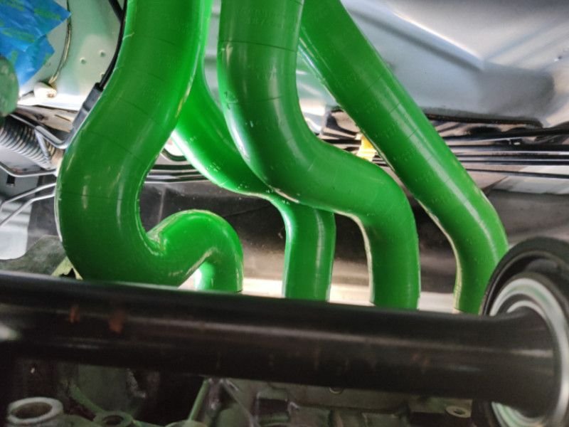

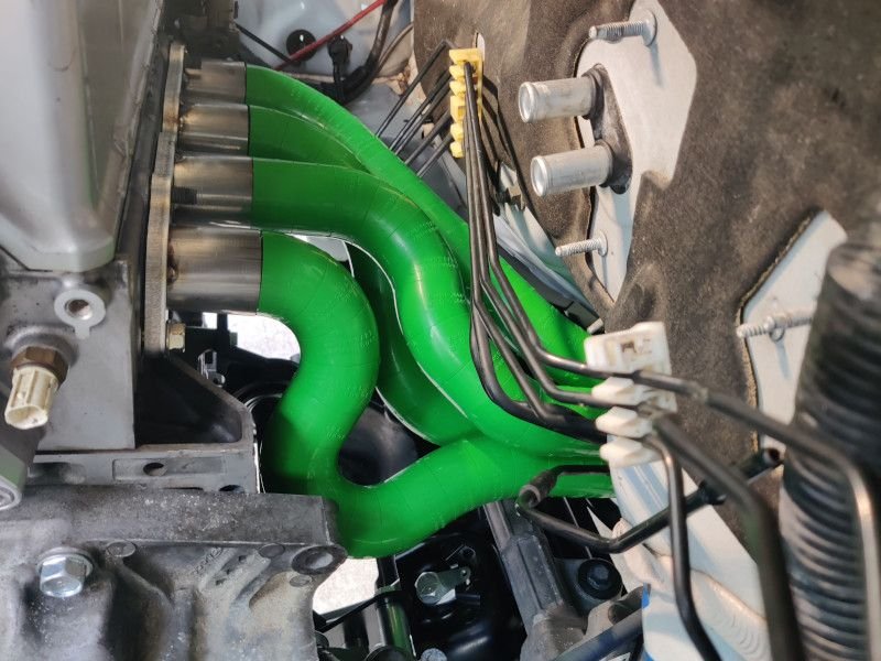

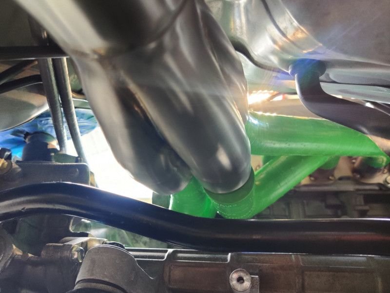

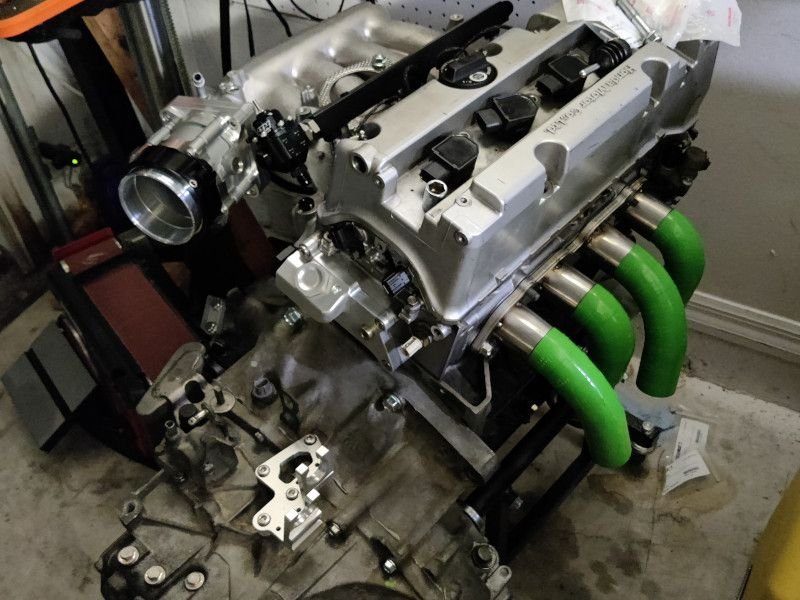

updates
Current header design from driver side
From under the car
4 to 1
Mid Pipe.

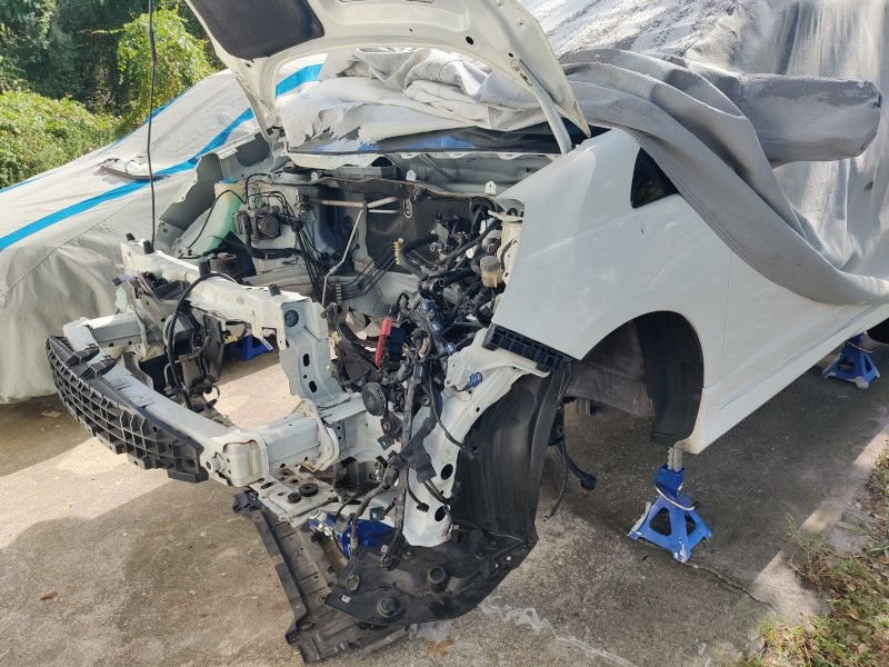

Switching things up again. Removed all the work I did on the front knuckles / cr-z parts and decided to try and get a 8th gen civic knuckle in.
It fits. I am looking at camber plates now and im going to need to get an axle combination that will work now. Im not sure what this is goiing to do to the suspension geometry but the clear benefits are
36mm axle
Bigger Brakes
Suspension upgrades / suspension that was designed for the heavier engine.
