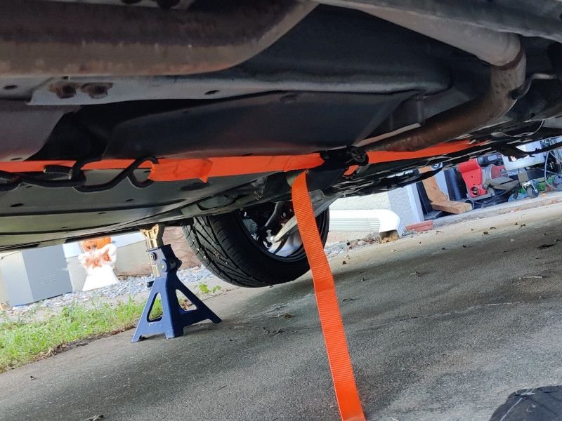

CRZ- Torsion Bar Install
This damn bar put up a lot of fight.
When you do everything by yourself you have to improvise sometimes.
I had to use the front brace to pull the torsion bar into place to get that second bolt in.
