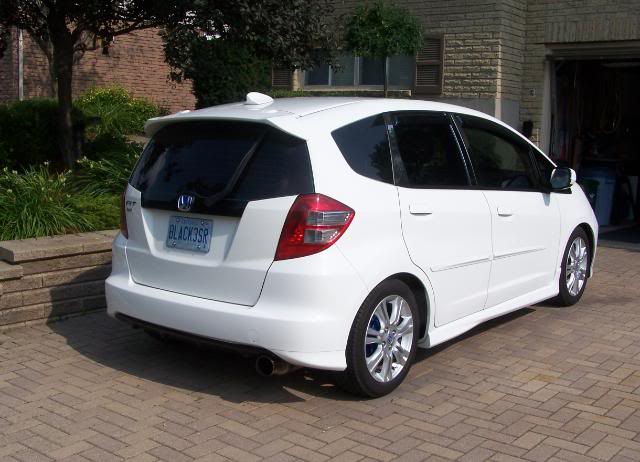

I bet it looks like this. Well the exhaust anyways.
