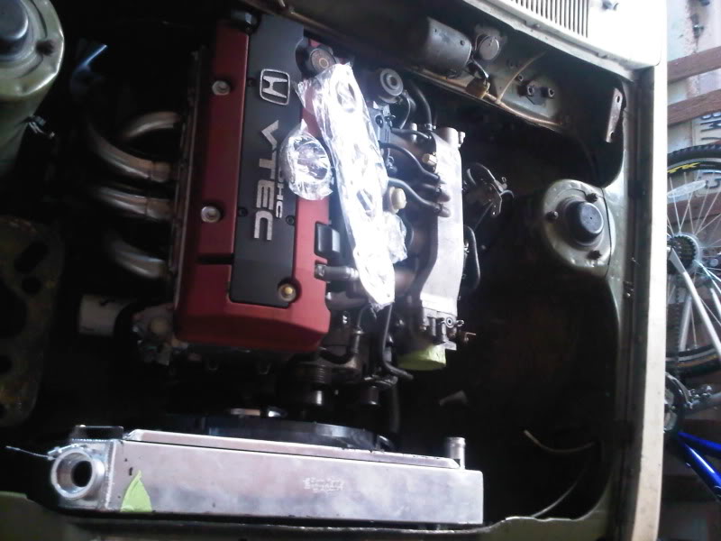

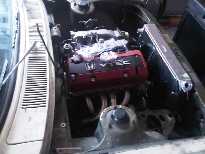

Pictures as requested.
510 engine bay

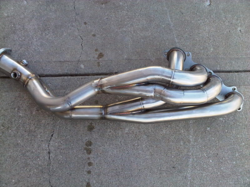

custom built header that started as a PLM

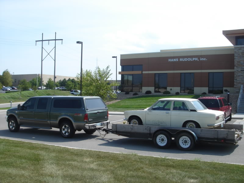

the car

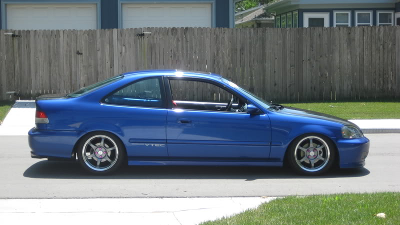

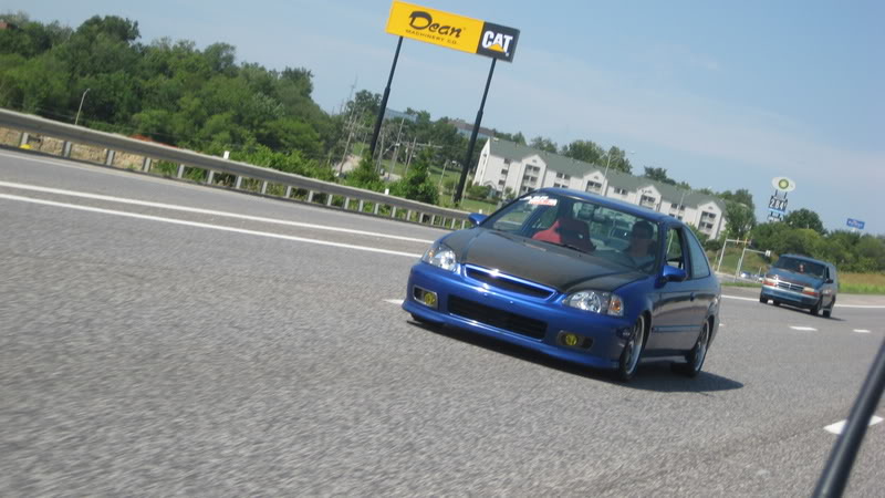

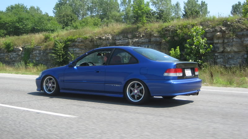

And my old si - I went 5 lug with JDM ITR GM wheels after these pictures but i never got pictures before i traded it.

So needless to say to i have a thing for modded honda's.

That looks like a good project man. I am also on DF210 and getting 17x7 for the fit. I'm not sure about the 205 though. I might run 195/45/17. I used this site: Custom rims, wheel tire packages for your ride - RIMSnTIRES.com to help me out. The reason why I will run 195's is because the odometer will be slightly off with the 205's. I saved you some trouble and wrote everything here (keep in mind, I'm using +38 offset but I doubt that it will effect these numbers with your +43 offset):

That 510 is wicked cool!!!
