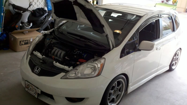

Originally Posted by krazEkid
what about a +38 offset with 16x7?
XXR Wheels - Style 002 Rims by XXR
you should be safe.
I had these 16x7 +35 w/ 205/45/16 tires on coilovers. no rubbing...dropped pretty low. COuld go lower but I think the fronts would rub..the rears clear no problem. I was on buddy club coilovers.
