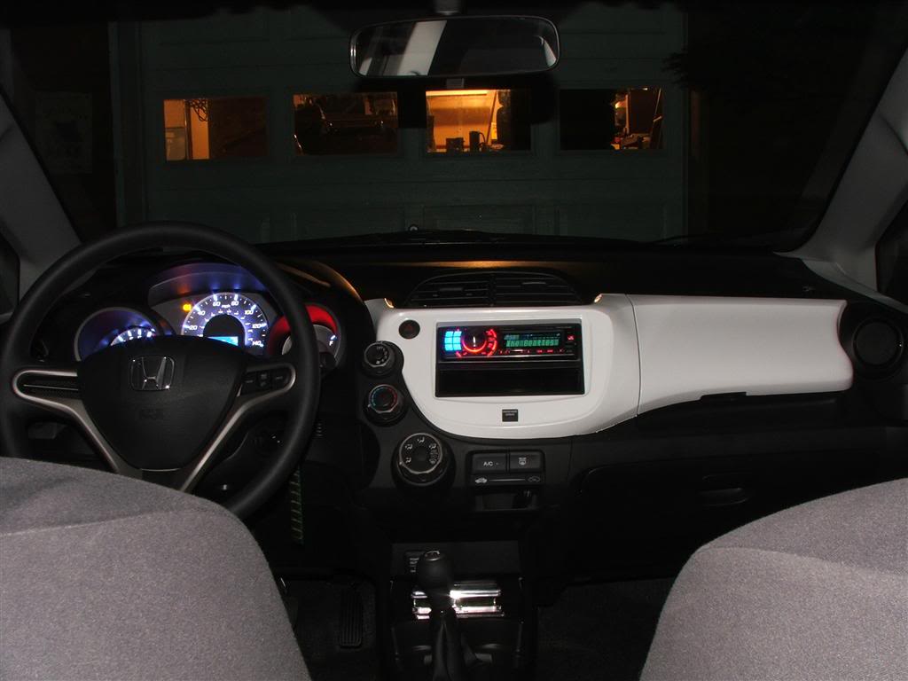

pic of the radio in my 2012 fit
http://www.ayushveda.com/wp-content/...t-interior.jpg
the only adapter I`ve been able to find: (the same one as the one in the post)
Amazon.com: Scosche 010HA1708B 2009 Honda Fit Double Din with Pocket: Car Electronics
The Scosche adapter mentionned has the air bag light at the bottom of the bracket while my 2012 Fit has the air bag light positioned next to the hazard button up and to the left of the radio. Anybody know where to get a DIN adapter for this?
