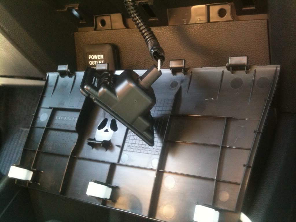

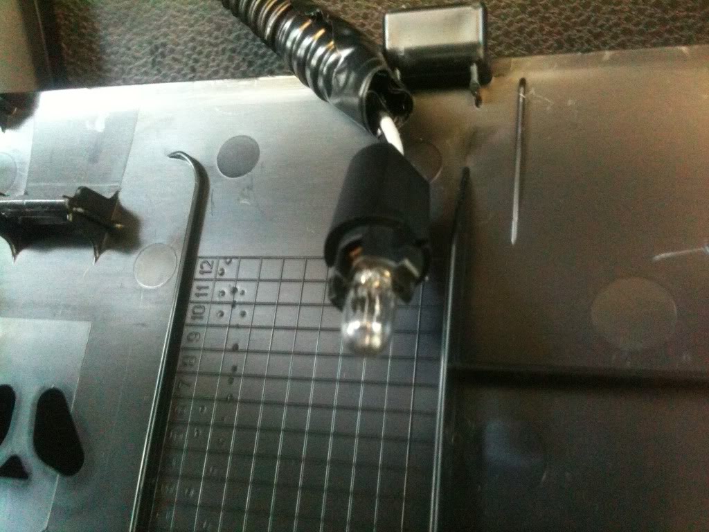

So I know there are already threads describing both installation of the dealer available ambient light kit as well various DIY projects courtesy of my innovative fellow forum members. I didn't find anything already posted describing the new center console light included in the 2012 Honda Fit. So I've decided to post some pictures along with my idea for a plug and play LED project to either make more light or provide some colorful illumination. I know this seems like a very simple idea, but nobody has posted pictures on FitFreak to my knowledge. I took this as a chance to help my fellow 2012 owners, especially those who don't feel comfortable messing with the wiring itself:
A picture of the fixture hanging out from below the center dash. Cupholder, center panel, and light bulb have been removed.
The removed center panel, note the three small holes which allow the light to shine through.
Closeup of fixture with light bulb in it.
Just the light, turned on.
I believe I've found a direct replacement LED, more on that soon...

Looks interesting! Can you please post larger pictures, I can't make out anything posted.
That better?

Thanks, MUCH better!

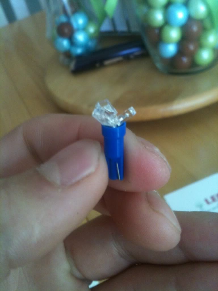

Did it to mine, 2012 crystal black pearl

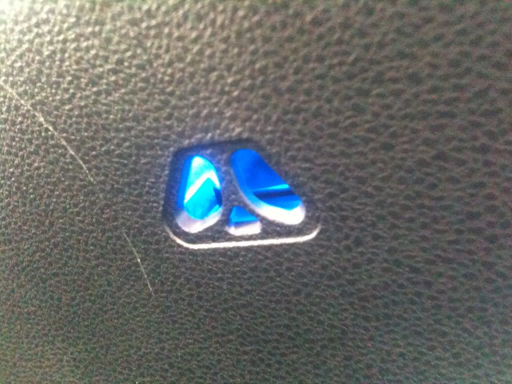

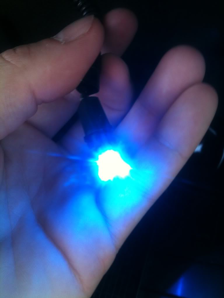

I had ordered T5 from the website above. It was only a couple bucks here are my results;
Here's when I got it in the mail
Here's the opened panel
Here's the exposed stock bulb

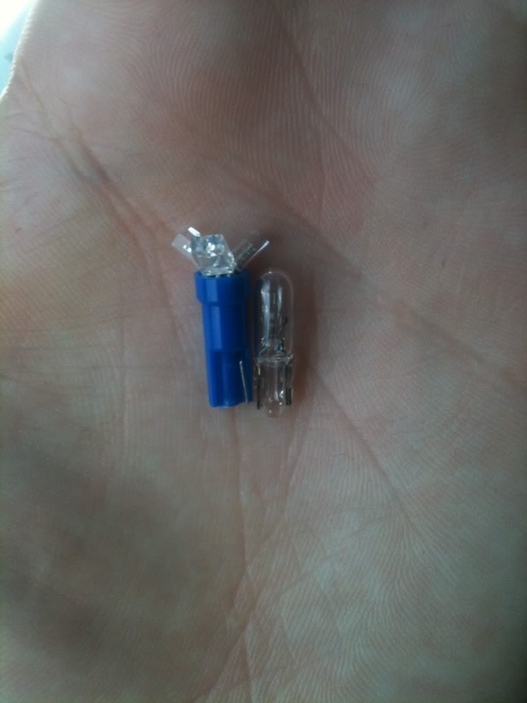

Stock bulb and T5 wedge comparison

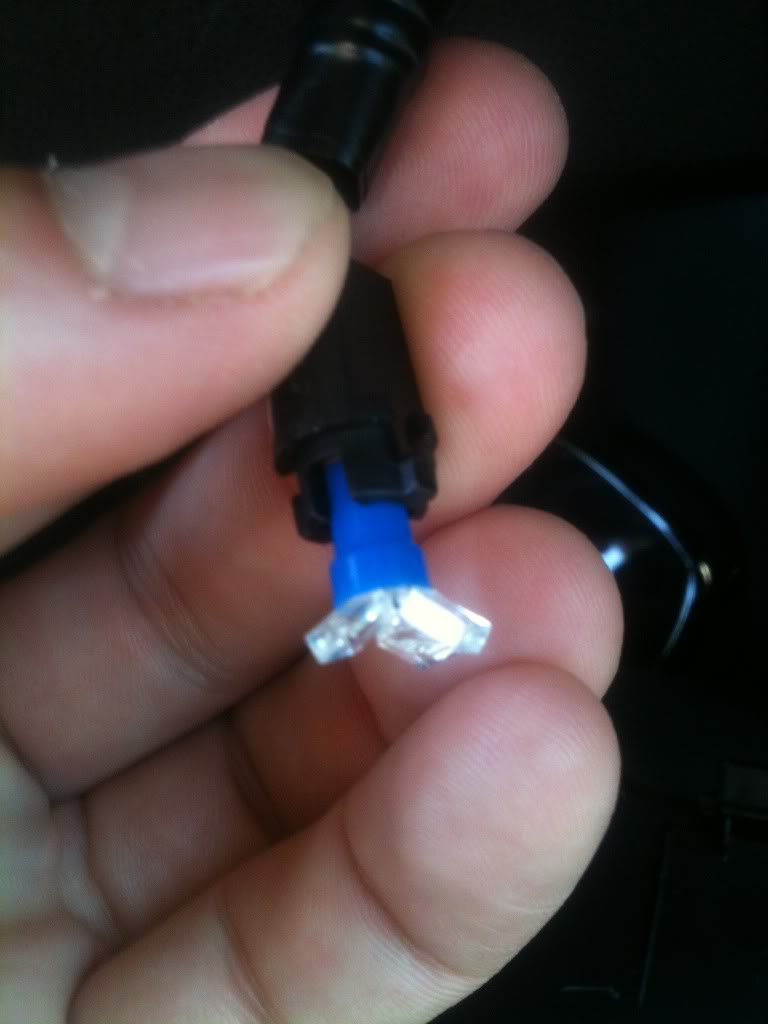

Inserted T5

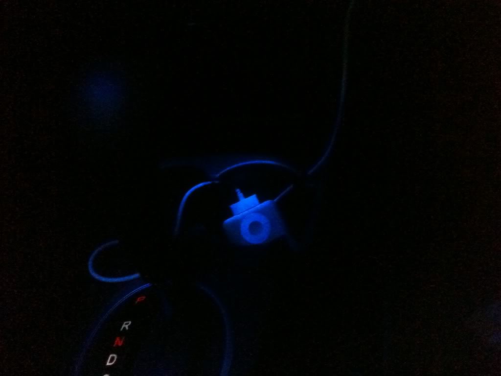

T5 illuminated
Illuminated with panel back on
illuminated at night
Sorry if there are too many pics! I'd personally rather have more pics than less! Hope this helps someone out. Took the pictures with the iphone, I hope they're clear enough

Thanks for posting this.
Any reason you went with the three-prong bulb rather than a round or whatnot that is also listed on the seller's webpage?

I tried putting a T5 in my 2012 Fit and it blew the fuse. The original was a 1.2w 14v white bulb. I will try ordering from the site mentioned above!
