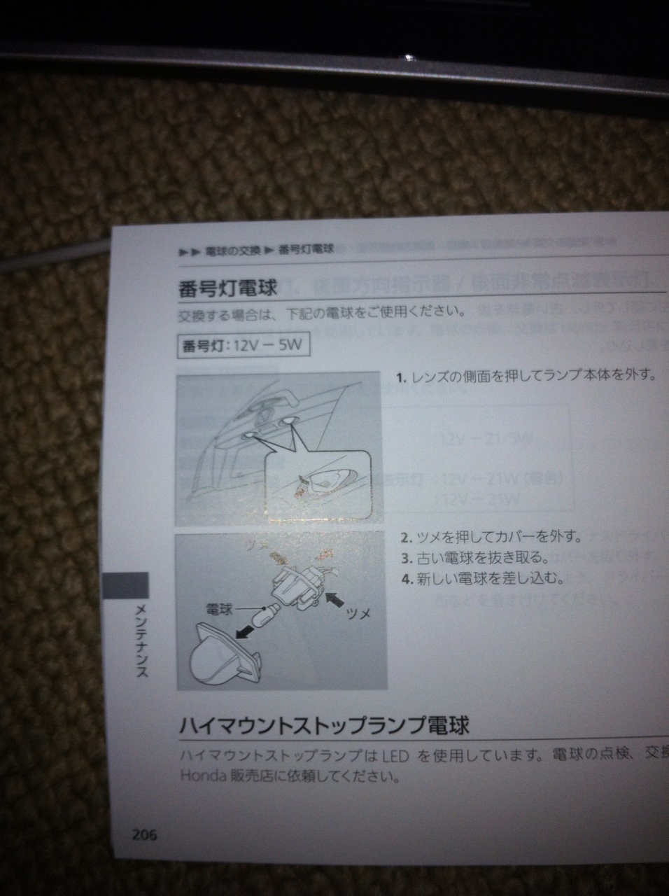

Octane in Japan is given in terms of RON, but in the US it's in AKI (RON+MON/2). A rule of thumb for conversion is AKI=RON*.95.
The Japanese Honda Fit manual says to use "Regular" which in Japan is defined as >=89RON. Converting 89 RON to AKI gives an AKI or US octane of 84.5, which I've never seen that low. In the Japanese Fit manual it says, "Although you can use Premium gasoline, it won't change the performance of the engine very much" It's on page 206, you've got a Japanese manual right?
プレミアムガソリンをお使いになることもで
きますが、この場合、本来のエンジン性能が
大きく変わることはありません。
My owner's manual, Pg 206 is talking about replacing the 2 bulbs at the rear license plate. What manual were you looking at as these 2 things are not at all related.
Just went through the whole manual and nowhere does it mention anything about Premium fuel (プレミアムガソリン). Only place it mentions about fuel at all is on Pg 189, in the specs for the 1.3L on Pg 253 and in the specs for the 1.5L on Pg 255. Maybe you were looking at a GD Fit manual or just made shit up to try and look cool?

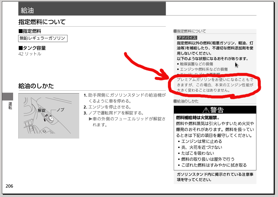

Lulz, you really think I made it up?
Here's the link to download the Japanese 2012 Honda Fit manual directly from Honda.jp in case you think I photoshopped the Japanese in. I'm sure there's somewhere in your manual that talks about premium gasoline, but in case it doesn't, download this one and look on page 206.
Honda | ??????????? | ???

My manual nowhere at all mentions premium gasoline, I went through all 263 pages. And regardless if the 2012 manual states such it doesn't apply to my Fit whatsoever. If you think otherwise, well when you have your ECU altered where it calls for a 2 step colder plug and the use of premium, go ahead and run regular and keep the stock plugs.
On top of that, Honda mentions you won't see much improvement, didn't say zero improvement. Again, most buying a Fit, especially here in Japan are using them as A-B car and not pushing the engine to extremes. So as already stated, running premium in this instance is not at all necessary. By Honda's own words, even if a small improvement, an improvement is still an improvement.
Next...
Next...
google translation is "does not change significantly." Interesting word, significant...

I should have known of all people you rely on Google translate. Horrid translation, but it does go hand in hand with your QuikTrip "R&D".
And yet still does not change significantly, but that still means a change is made. Just give up your feable attempt to discredit sonething you will not even test for yourself. Then again the world is flat according to your everyday pandering about.

what I've learned from this thread:
1) "regular" octane gasoline in Japan (89RON) is lower octane than here (87AKI) and not the opposite as has been claimed by the "experts" on this board.
2) Honda Japan in their 2012 Fit user manual recommends regular gas, and while premium may be used, it does not change performance significantly.
Research is a wonderful thing.
