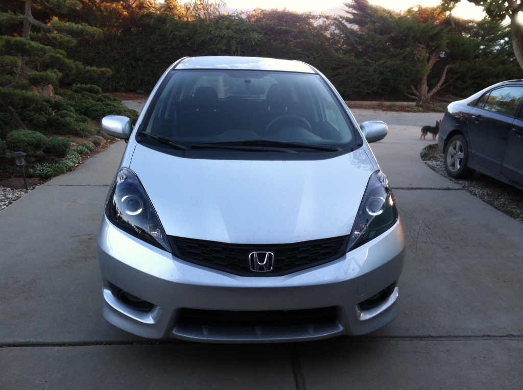

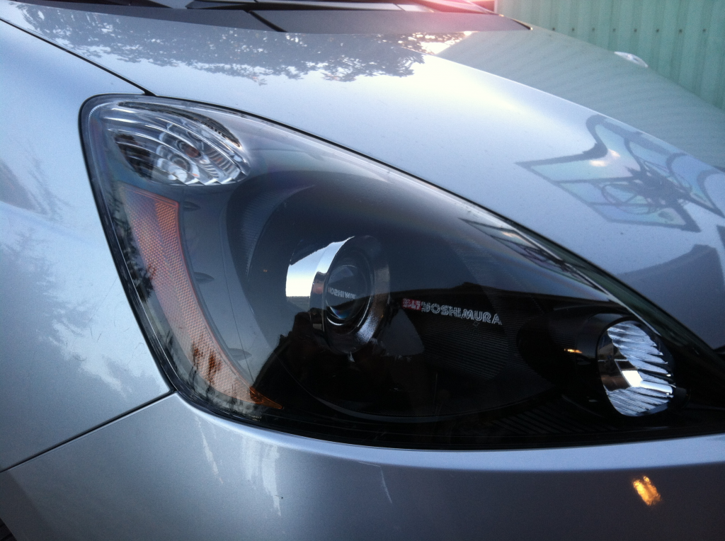

Morimoto FX-R projector HID retrofit finished
First, on the original topic, the HID's in the fogs made a huge difference in light output. Yes, the light is scattered compared to my new HID Projectors, but nonetheless very bright by at least a factor of two.
The retrofit HID Projectors turned out so nice that frankly, I am amazed. The roadway is lit up like never before and the cutoff is laser sharp. I painted the reflector rattle can satin black and am somewhat satisfied. I may take it apart again to inlay carbon fiber cloth.

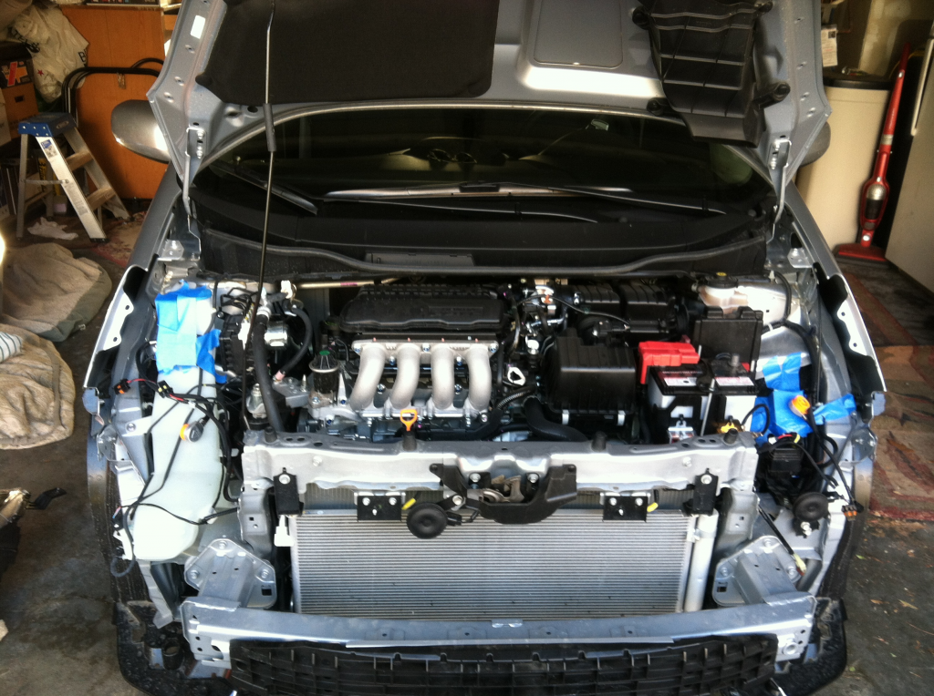

Here's a pic of the Fit being prepped for a new HID Projector retrofit. Name:  FitHIDprep.png

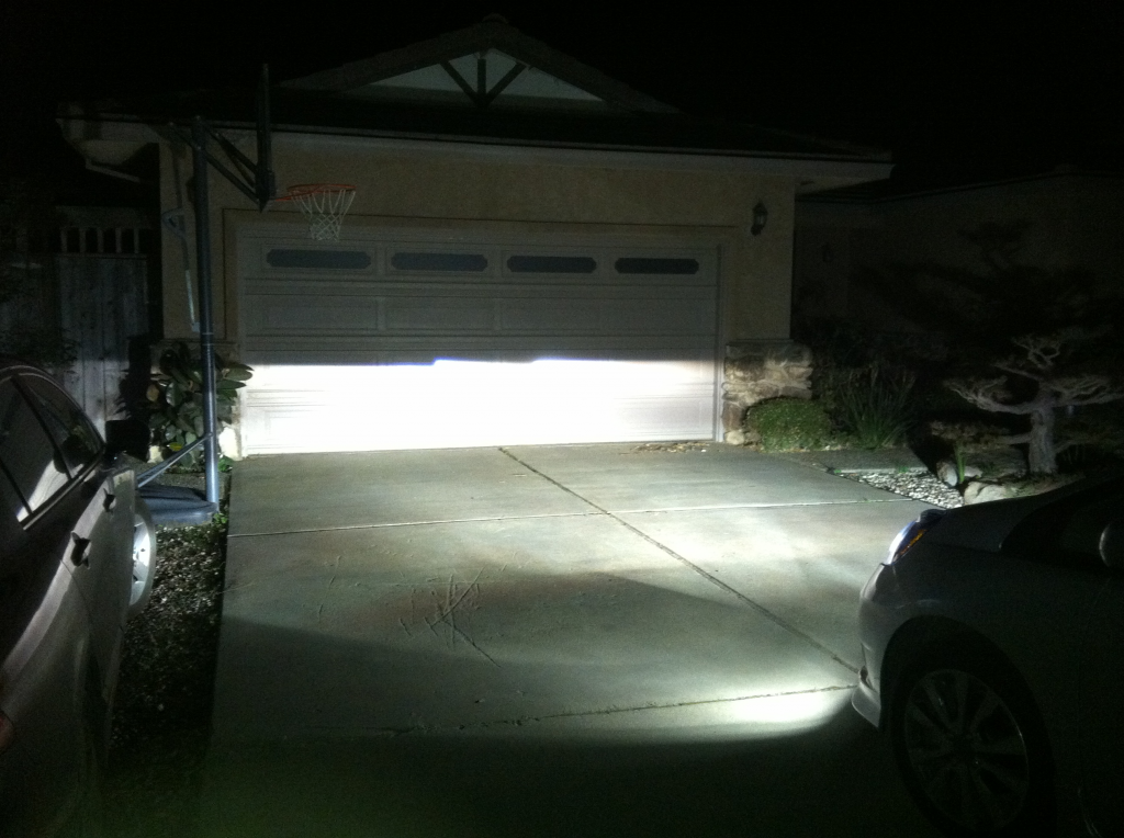

And the new beam pattern. Name:  HIDprojectorSpread.png

Where I live in California, the chance of fog is about pretty high in the mornings. The fogs come in handy when I'm feeling my way around at 30 mph on a rural road. The fog lights help light up the side of the road close to me which allows me to know I'm on the road vs driving off of it. The extra glare from the brighter HID's has not been an issue and the extra lumens definintely helps. With the HID's the area in front of the Fit is significantly more illuminated than stock. Now when I turn on the fogs, I see a bright area of light which fills in what the low beams do not closer to the car.
