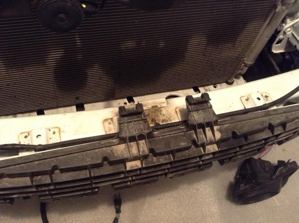

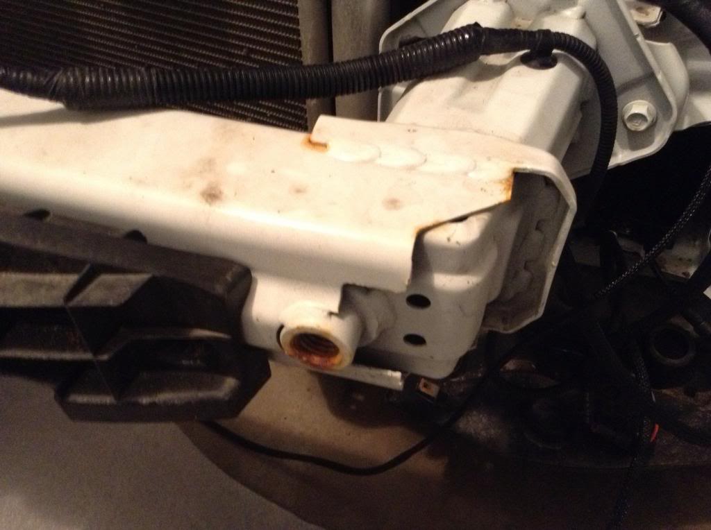

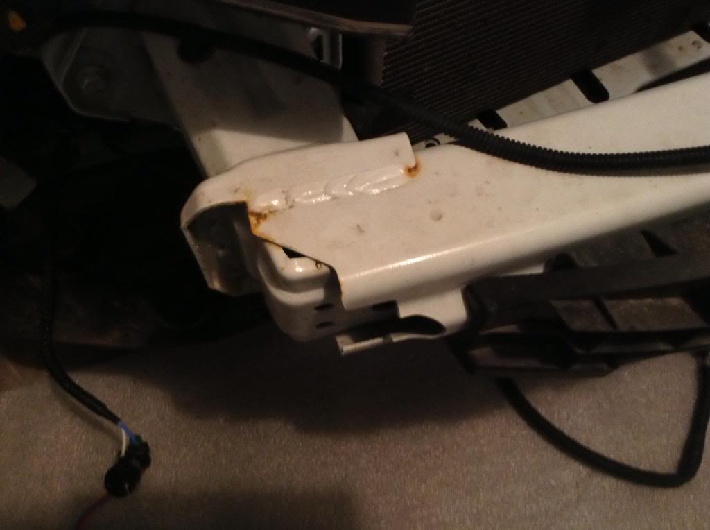

*UPDATE*
There is also a large amount of rust accumulating on my front crash bar. I am not sure if this is specific to the Chinese made ones, but I am having this checked as my car was only a year old when these pictures were taken.

Needless to say, I'm going to take it in as this is a warrantable item. Anyone else that has a Chinese made fit should also check. All you need to do is peel back the rubber a bit along the top of the door to see if there's rust.
If you're not sure you have a Chinese made fit. Check your vin number, it should start with LUC.
