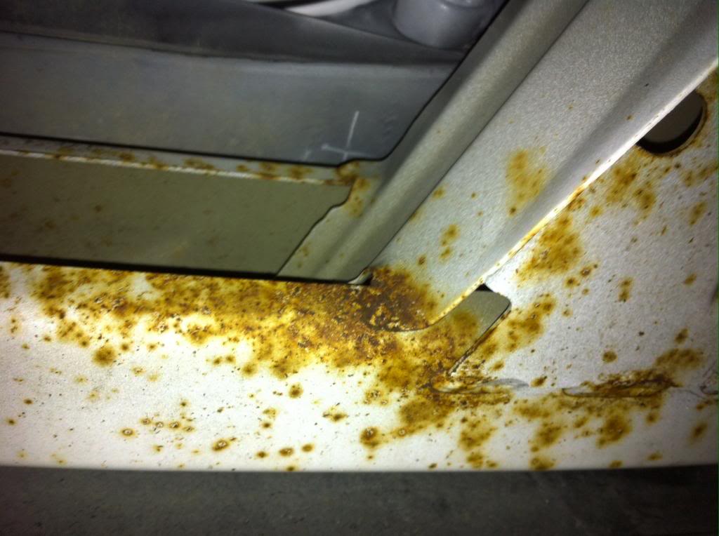

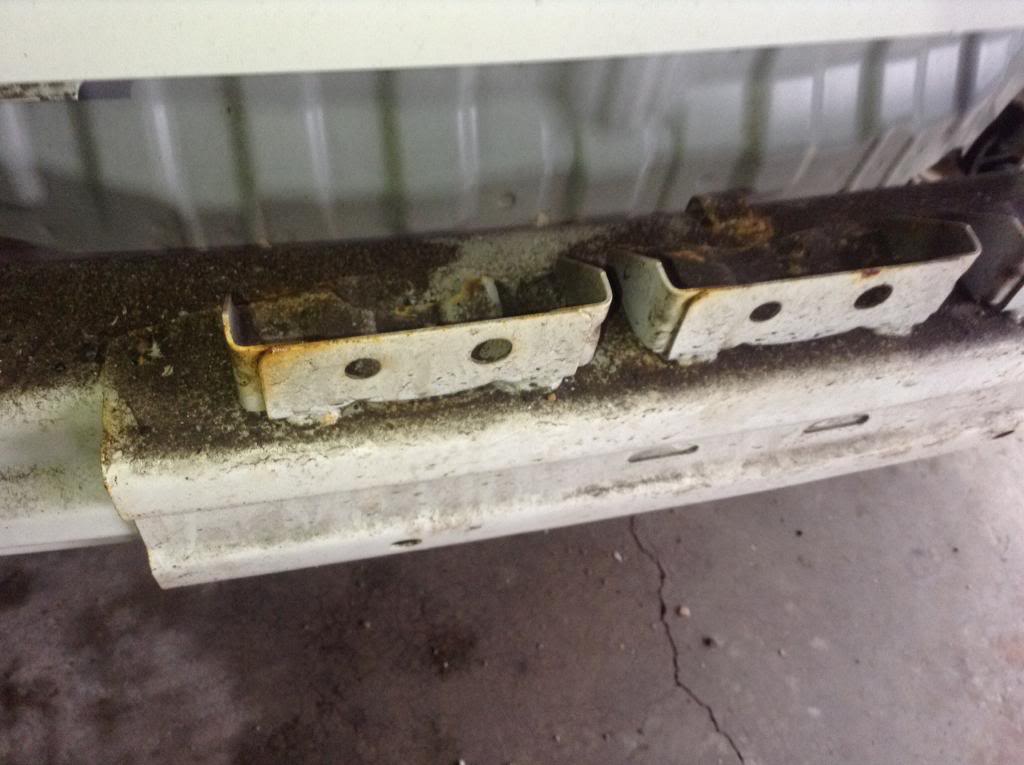

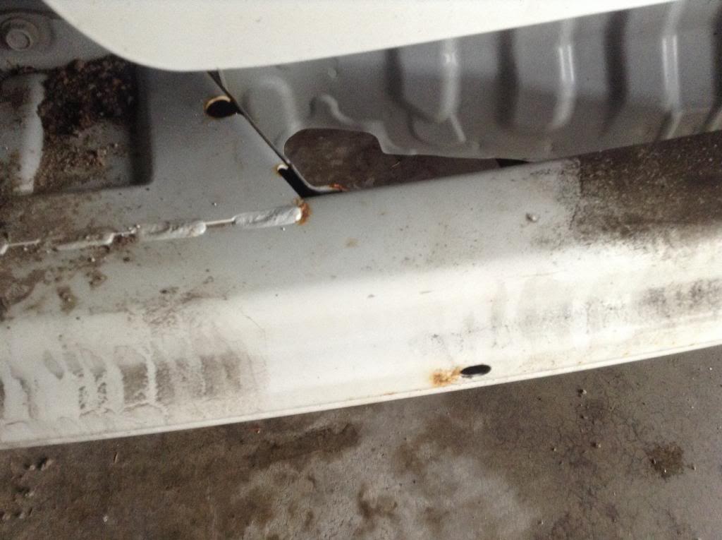

Had my rear bumper off the other day and found these Gems behind it.
So far, the problem does not seem to affect the main body at all (thank goodness), just the crash bars and other extremities.
I wonder why this is?

Car is a 2012 fit bought march 2012. Not impressed... taking this into get looked at, and will make it my top priority.

Thanks for posting those connor55, I'm curious, did you take it to the dealer? What did they say? Something tells me they won't be too thrilled to address the problem until it rusts right through...just in time for the warranty to lapse.
I've been keeping a close eye on what I can so far on mine, no rust yet. Unless something at the factory was changed from the 12's to the 13's, I feel it's only a matter of time
All of those rust spots were hidden right under the bumper assembly? I'm hesitant to remove mine to look.

I've taken it in to get looked at and opened an official case with Honda Canada.
Long story short, right now they are claiming this is normal and acceptable because it has not "perforated" the metal. I'm not going to settle for that but haven't had time yet to follow up with them.
They told me at the very least that if a real structural problem arises from this in the future, they would cover this even out of warranty, since they were made aware of this at this stage.
I would advise the rest of you to see if you have similar issues and let honda Canada know. It's possible that we can make this into a "known" issue much like the blower motor issue.
