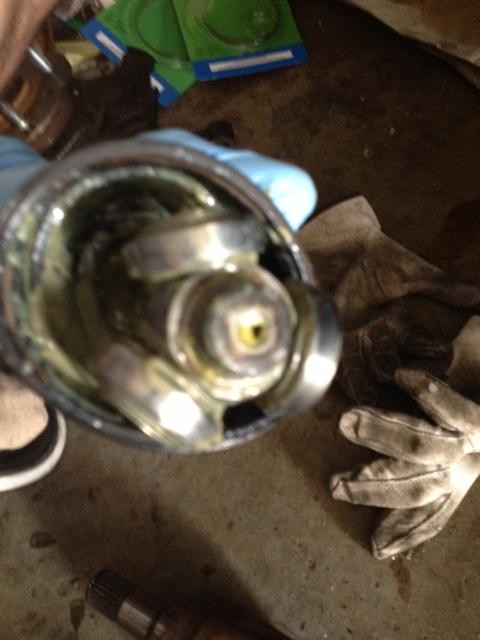

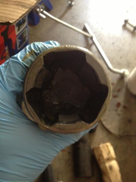

kentkanaya's Avatar
Joined: May 2012
Posts: 72
From: Atlanta,GA
Ok i got the driver side axle off, and cut the band off and everything went well after that. I got picture of it too for future people if needed. Dont know why i couldn't get that thing to go back in knowing such a simple design....
