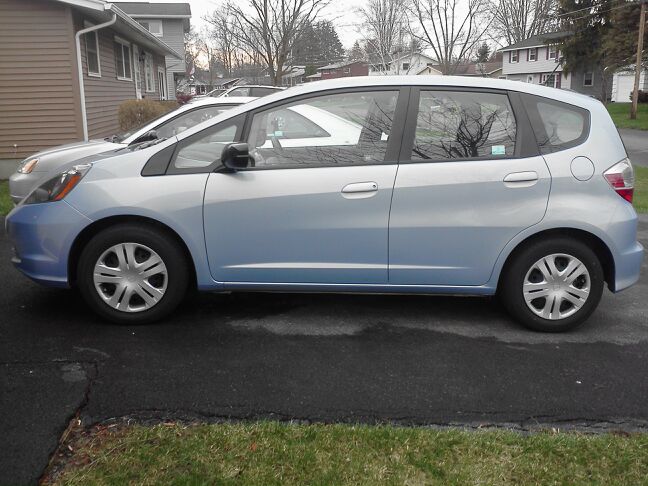

I recently purchased a base 2010 Tidewater Blue GE8 with a manual transmission, so far I am loving the car except for the drive by wire throttle and steering which feel lifeless to me, and the hideous wheelcovers that came stock

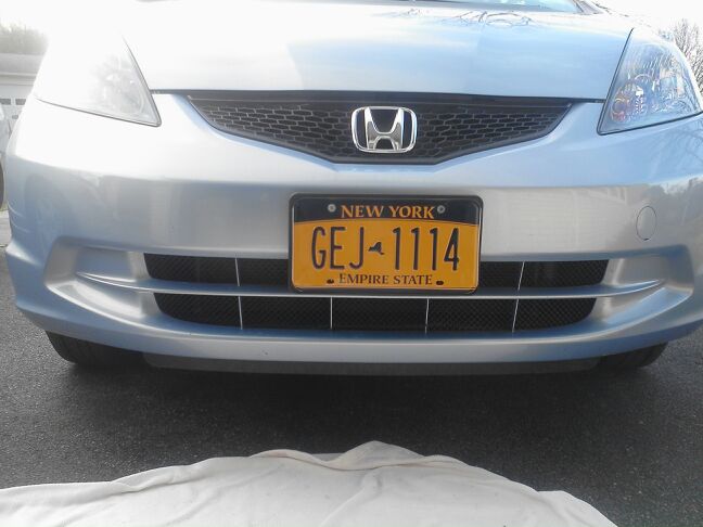

Fit Freak has been great help to me so far. Most of my questions have already been answered by you guys, and as per your recommendations I have fashioned a lower grille to protect the A/C compressor

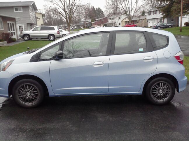

, and used the washer trick to make the seat more comfortable. So to replace the steelies with wheelcovers I put some wheels that I used to have on my old Civic, they are 15in wheels from an integra and have wider (185/60/15R I think??)
They give the steering a little more feel and the wheels look good on the Fit IMO, and clear the calipers fine but what I was wondering was, are the stock lug nuts from the Base model ok to use with Alloy Wheels, they are different than any other lug nuts on any other car I have had, they seem small and aren't fully enclosed
can I use these with the new wheels or should I buy Chrome fully enclosed lugs like on the sport trim. I would need the acorn style of lug nut I believe and I think the size is 12 X 1.5 Please correct me if I am wrong.

Yes you need acorn type lug nut, hope you don't drive alot cause your risking a wheel coming loose......no bueno

You need to do something now. Those lugnuts are NOT engaging enough threads on the studs to hold the wheels on safely.

The lugnuts you had were fine. Do you think that enclosed lugnuts will magically make the studs longer? No, they will thread the same amount. If you had vibration it's because you didn't torque wheels right, wheels need to be balanced, or a wheel is bent (unlikely).
Those open end lugs sure do look ugly though
Just get ball lugs for Honda. Those are OEM Integra wheels.

Horse pucky. You can clearly see those lugnuts are not engaging enough threads on the stud. Clearly those wheels are too thick for the stock studs it's not the lugs in this case it's the studs are too short for those wheels.

Checked for sure, the lug nuts and wheels are both ball set, but the Integra wheels are thicker than the stock steel ones, could the fact that not enough threads were being engaged be the reason for the slight vibrations because when I put the wheels away for winter they were balanced fine? I think that since enough threads aren't being engaged I'll probably just sell the wheels on craigslist because I don't wan't to compromise safety even if its only minimally, then save up for some decent 15in wheels that wont be too thick for the studs off tirerack with snow tires and then just swap the tires so the snows are on the steelies.

Great that you figured that out. You need either longer studs (expensive) or thinner wheels (also expensive) but it's great to see you are choosing safety over "coolness".
There is just not enough threads being engaged in the present form. You can tell just by looking at the lugnuts and see that the end of the studs DO NOT protrude from the lugnut. Set up like this will NOT pass any racing sanctioning body inspection or state MVD safety inspections no matter what the people here are telling you.
