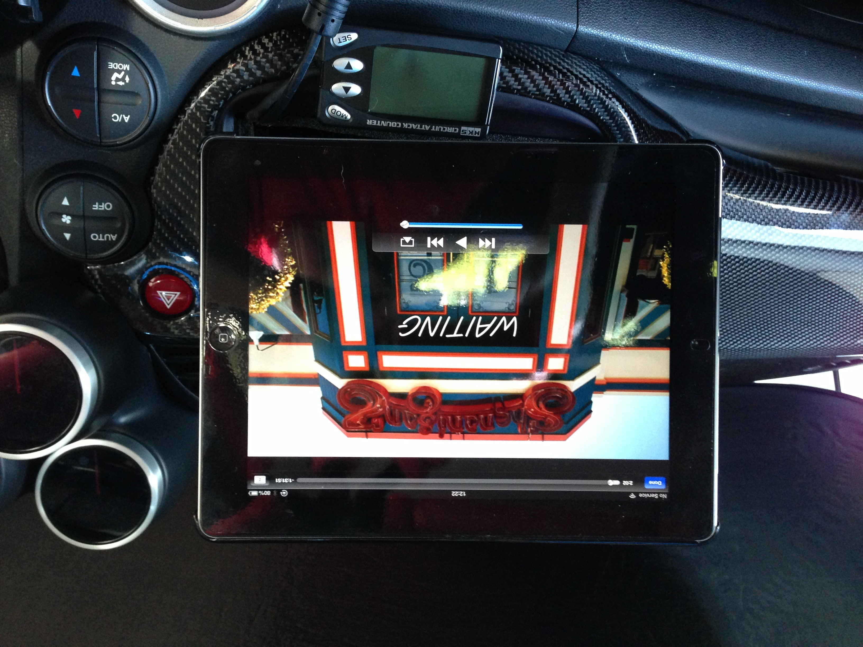

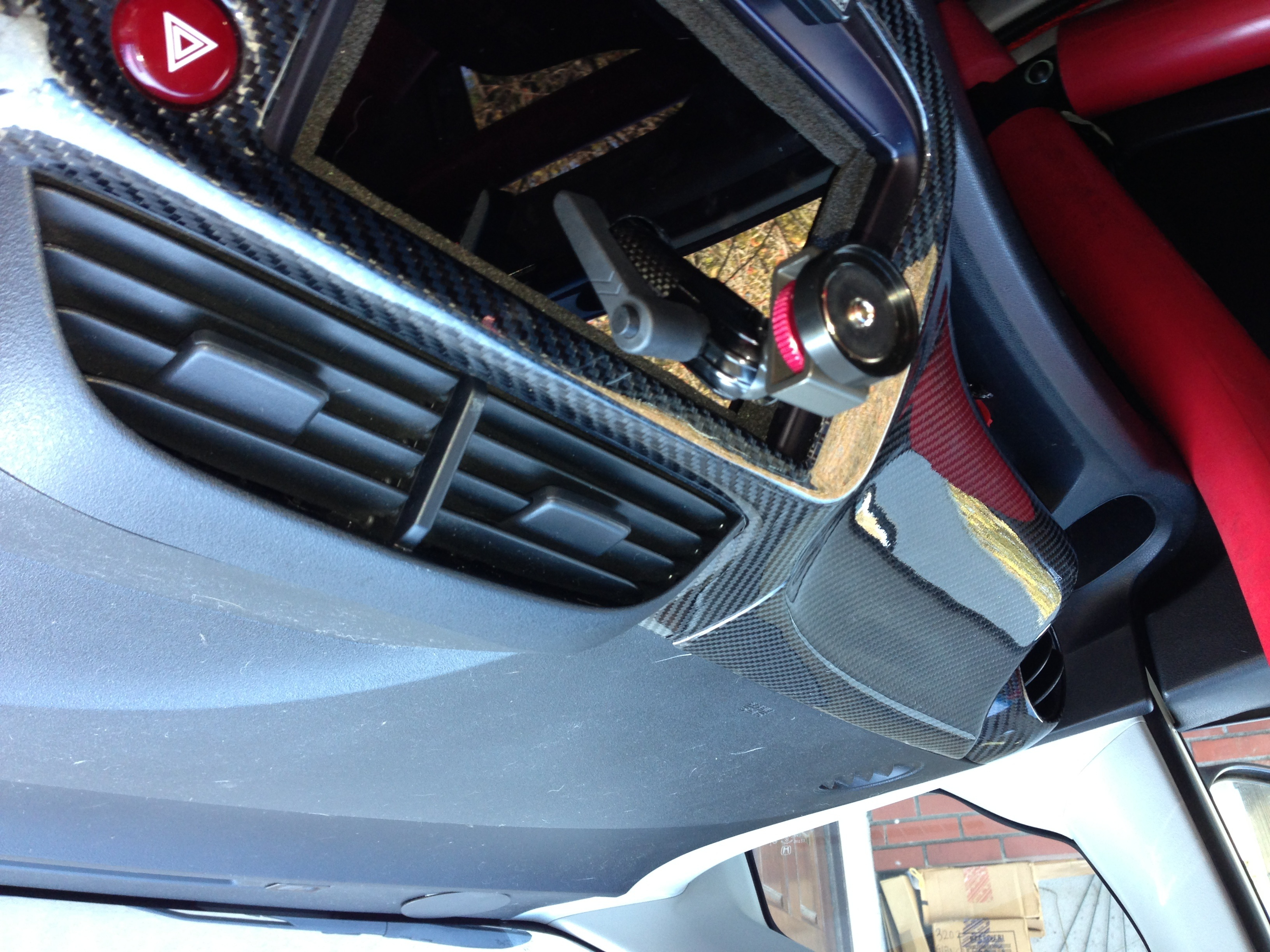

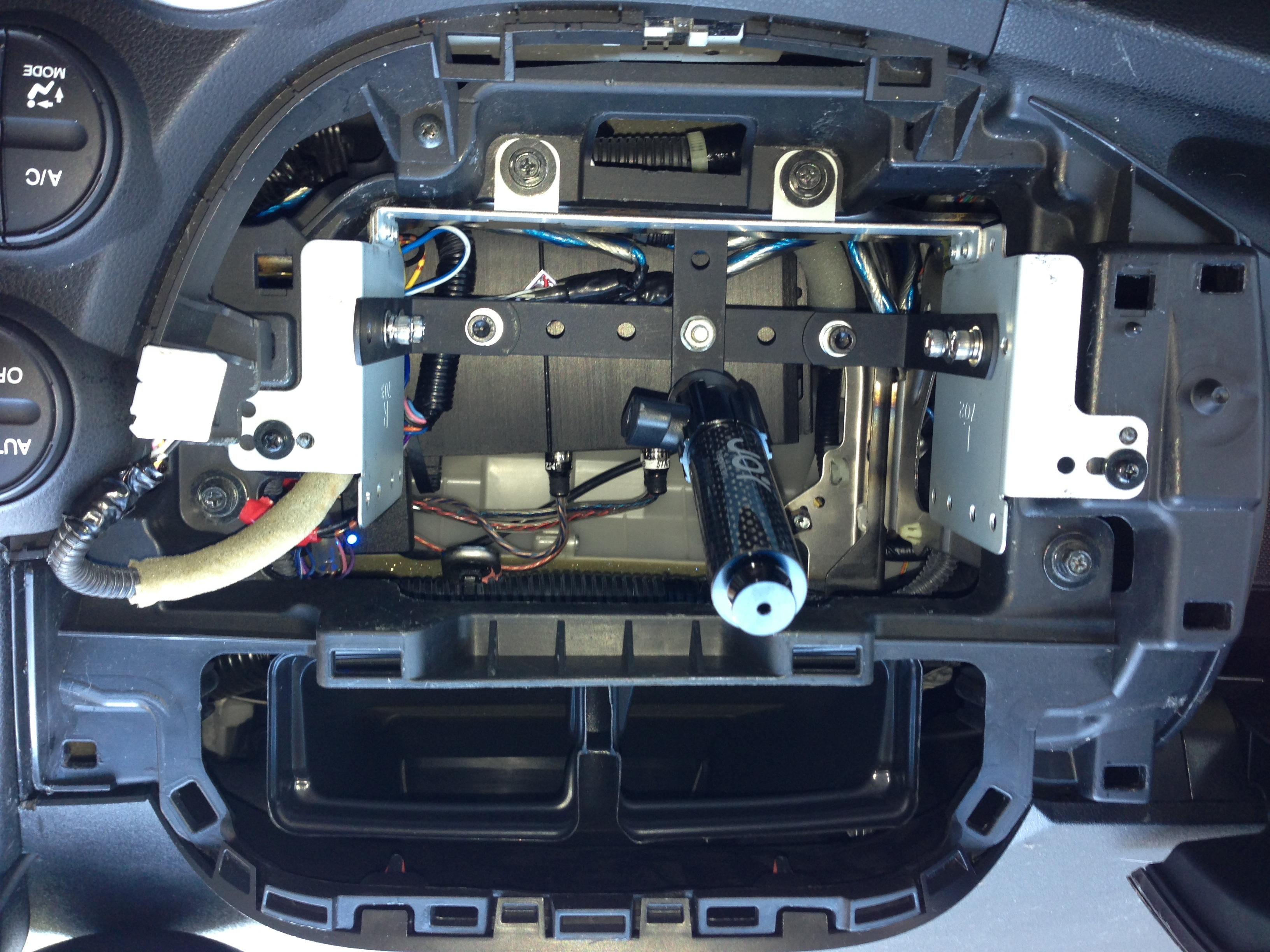

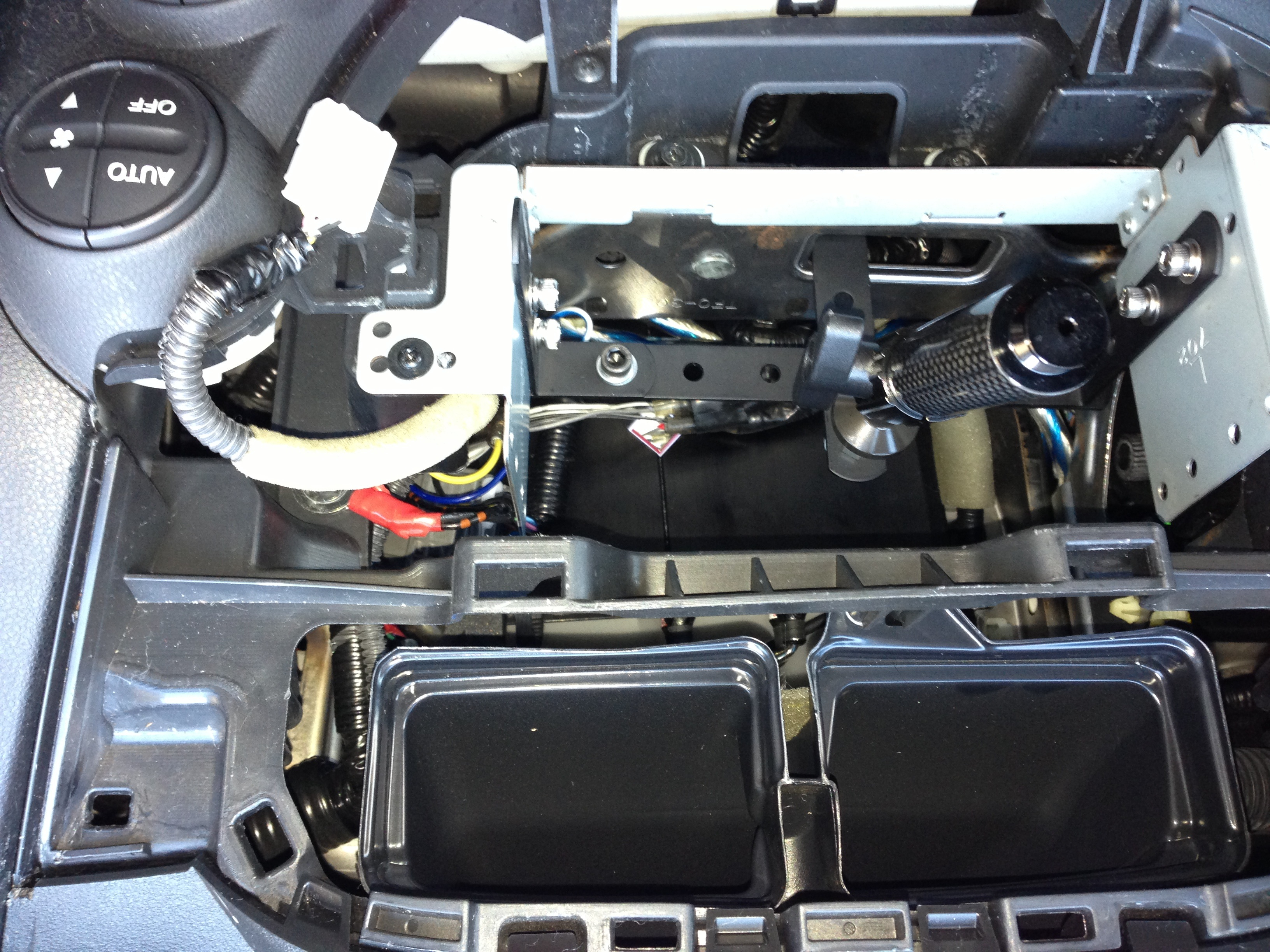

I use an iPad for my head unit, well display. I have a RF processor that the iPad connects to by BT and my amps are connected to the processor.
I have a JoyFactory mounting arm with 5/8" camera thread mount mounted inside the double DIN space with some metal brackets attached to the side stays of a kit I picked up to mount my own head unit as I ordered my Fit with zero audio. I chose this method as it is easily removable, but might not be to the liking of some.
I also have a Nexus7 that I wouldn't mind using, but JoyFactory doesn't make a shell for it and also it is limited to 32GB versus the 128 in the iPad. I do have a few network hard drives that I could use if I went with the Nexus to up its limits on size.
