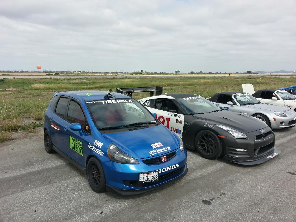

I have also helped develope and compete against 2 well sorted GE's. Here's one on on the RedShift Koni/GC setup with the front bar connected, exiting a sweeper and still showing negative camber on the inside (-3.0° camber static, dampers set to soft)
[IMG]http://i824.photobucket.com/albums/zz162/TPColgett/IMG_404300464000983_zps54d090a3.jpg[/IMG ]
If you want to know anything, I'm happy to share
